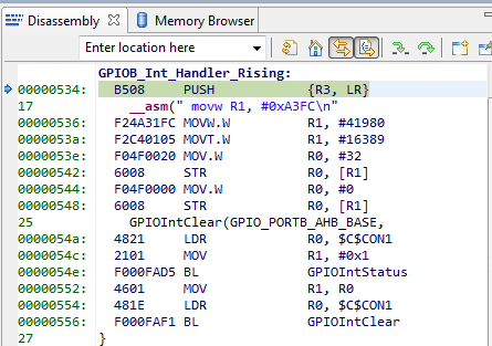

void GPIOB_Int_Handler_Rising(void)
__asm(" movw R1, #0xA3FC\n" /*load lower part of GPIOC port addr to r1*/
" movt R1, #0x4005\n" /*load upper part of GPIOC port addr to r1*/
" mov R0, #0x20\n" /* load "on" pin value to r0 */
" str R0, [R1]\n" /* write value of r0 to GPIOC port */
" mov R0, #0x0\n" /* load "off" pin value to r0 */
" str R0, [R1]\n" /* write value of r1 to GPIOC port */
GPIOIntClear(GPIO_PORTB_AHB_BASE,
GPIOIntStatus(GPIO_PORTB_AHB_BASE, true));

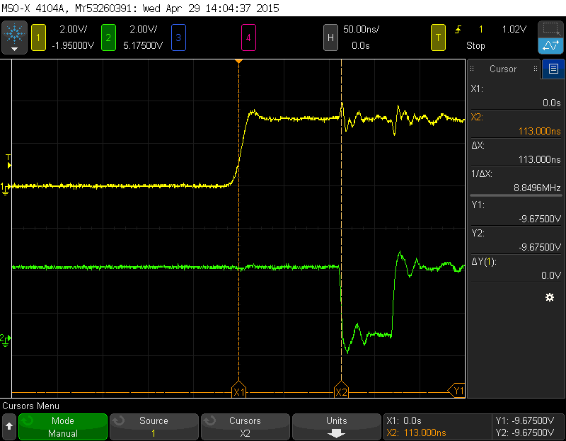

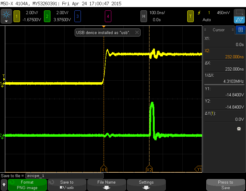

This is what I see on oscilloscope:
As far as I'm aware, it takes twelve clock cycles to launch interrupt service routine, my assembler code takes another five clock cycles (four to execute and one cycle for gpio pin rise delay) to execute. Together we have seventeen to eighteen(if rising edge on PB3 arrives when system clock is high) clock cycles. System clock runs at 120 MHz frequency, so its period is 8,333 ns. This gives 18 * 8,333 = 150ns of the delay. But on the scope I see about 230 ns of the delay, so where's missing 80 ns?
