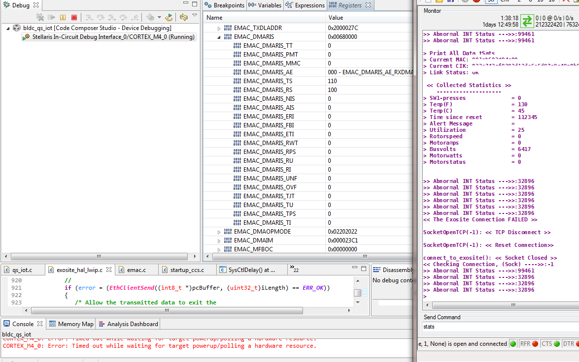

  • Hello BP101,
    Are the EEPROM Registers open in the memory or register window?
    Amit
  • Registers window and the offset address cycling is all in block 0.
  • We suspect that Amit's "fearful" that if your EEPROM Registers are "open" w/in your IDE - that may be the cause of your observation.
    It's unclear if you've answered his question...
  • The registers are open in debug while the application is running and in register refresh order we can reveal what and why. This appears to be undocumented EEPROM idle behavior in block 0. The question is how to make it stop cycling addresses without disabling the peripheral.
  • Hello BP101,
    Ensure that EERDWR and EERDWRINC are not in the IDE register window.
    Amit
  • Hi Amit,
    Disabling those two registers stops the offset addressing but to what point. We need to know is SW is actually reading the EEROM after blocking SW from repeatedly reading EEPROM. The only noticeable difference is the EEOFSET addresses appear more random without SW blocking.
    So you are implying the simulator is spoofing the registers causing the EEROM to increment the offset address?

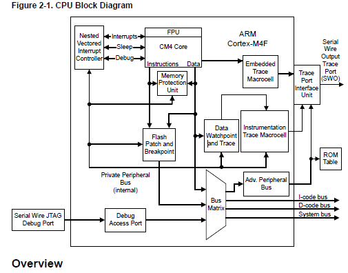

  • "JTAG has access to the peripheral register via the DAP. If not then how can one set a GPIO Data Register and expect the pin corresponding to it to become high."
    Not sure how that can be possible since all that ICDI can do in CCS debug is read the DAP for slower than ever register event updates and write flash memory addressed data with the application object. The MPU executes the application object which eventually asserts the GPIO port pin High not directly via the JTAG port.
    The diagram posted above shows the JTAG pins have access to the DAP which arbitrates data flow onto the local bus in order the flash memory can be written with the object code. If there is some utility that allows JTAG or ICDI to have direct access to registers then we should be receiving near real time updates in the CCS debug registers window. My Intel quad core 2.8GHz processor is pushing the USB data from the ICDI into the CCS debug at break neck serial speed 250KBPS. Have heard other over clockers state they double that USB v.2 speed.
    "Remember that the CPU bus is 32 bit @ System Clock but JTAG is a serial Stream @ TCK (with overhead of IR and DR), which would make it way slower and refreshes not that fast."
    The trace macro cell is also slow to retrieve every event change in all the peripheral registers and mirror all that data up the DAP. Seems if the debug had direct access to register the EEPROM should not be incrementing the EERDWRINC just by reading the idle register. BTW the USB 0-7 FIFO's are doing the same thing and no serial data is entering or leaving the OTG port.
    You've misunderstood, it doesn't have access to the EEProm (or any other external peripheral) internals. It accesses them through the data bus just as the micro does.  The JTAG is integrated with the micro Core by ARM, the peripheral, including memory, are provided by TI. As such the only internal representations the JTAG/Debug core has access to are the core's and even that generally appears to be limited.
    As far as the peripherals are concerned, the JTAG appears to behave like a microcontroller accessing their exposed registers. And keep in mind that in a number of these registers probably do not keep any sort of internal mirror.  The EE address register is probably one of those.
    Robert

  • As such the only internal representations the JTAG/Debug core has access to are the core's and even that generally appears to be limited.
    That is exactly my point the ARM trace macro cell is the core trace storage for the vendor provided peripheral interface on the local bus. All vendor related peripheral data is monitored by the trace macro cell and ported up to the DAP. That way any vendor peripheral caused precise bus exception and processing is handled by the MPU core when the trace cell detects error in the vendors data stream. Otherwise the core would crash and the MPU halt anytime the vendors peripherals or ICDI/JTAG debug interject unscrupulous data on the local bus. There are many core register settings one is to have the MPU keep running during an exception event. One such core option allows priority write access to protected vendor registers. NVIC interrupt register for setting SW interrupt triggers.
    Never suggested the ICDI had access directly to the EEPROM peripheral addresses . If JTAG can directly access and set bits in the vendors peripheral registers as Amit suggests then why doe CCS debug have issues to properly follow the registers events. The best explanation is the ICDI register event data is disconnected mirrored history. The entire argument lies on the point the EEPROM is no longer being accessed by the application in so the EERDWRINC should not by design be Self incrementing offset address inside block 0. USB0 is doing the very same thing with FIFO registers 0-7 addresses cycling like mad when no external OTG activity. That behavior also infers the CCS debug and ICDI/JTAG is not directly in contact with the vendor provided peripheral registers.
    Because it is reading a register that auto-increments when it is read.  To keep the data up to date it has to re-read the register. That is a direct consequence of reading the peripherals exposed registers with no access to the internals (although I doubt deeper access would help).
    BP101 said:
    Never suggested the ICDI had assess directly to the EEPROM peripheral addresses
    But it does, that's how it works. It directly accesses the EEProm's registers via the data bus.

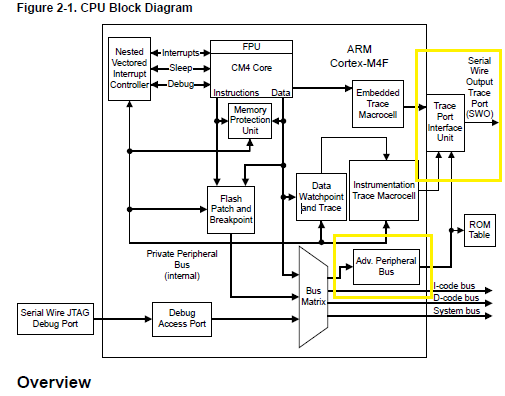

  • Meant to type SWO not SWD last few posts (back edit). The advance peripheral bus yellow box is the vendor bus in my mind and see how the trace macro cell connects to it, then SWO exits in my mind out to the SWD/ICDI AKA JTAG.
  • Which does not contradict anything I've said. If you display a register the debug has to read it (trace doesn't enter the picture). SWO is simply the communication mechanism for the results of the debug read.
    Robert
  • The former usually picked to improve single step performance,
    Seem to recall reading application single stepping occurs in the ETM and exits SWO out to SWD/ICDI. We don't actually execute the object from SRAM when stepping into the embedded simulation. Good explanation of why the disassembler view has addresses that differ from the SRAM address range.
    Given that data passes out the TPU it would seem plausible the debug registers view could also be receiving update data from the TPU.
    The TPIU is just a data port, not much intelligence. Any register you see must be read via an explicit read.
    Note that the ITM and ETM only have connections to the core so they cannot even 'see' peripheral registers.  You might not need to go through the bus to access the CPU registers. The TPIU has connections to the bus it can be used as a communications port for the DAP and application.
    Robert
    The arrows of bus data flow point from the APB (vendor peripherals) up to the TPIU out via SWO and not from the APB out to the SWD. Think more is going on here with the reading of vendor registers than some are believing possible.
    You are violating the principle of parsimony1.
    There are two things to keep in mind when reading a manual (particularly a manual for a microcontroller)
    1. If a secondary behaviour is not needed to meet the requirements of another described behaviour you must not expect that secondary behaviour to exist. None of the behaviour you are describing is needed to provide the interface described.  You cannot assume it will be there and experience shows that it is not.
    2. Just because you would have implemented something in a particular fashion does not mean the designers of the core did. And they likely have perfectly valid reasons for designing the way they did.
    Note: that number 1 is a good position both from an abstract point of view from managing expectations and from the view that generally implementation will be as simple as the designer can make them in order to contain costs and produce a testable, proven to work product.
    In summary, according to the documentation (and behaviour)
    • the TPIU acts as a simple interface to the ITM and ETM. In addition it exposes an interface to the peripheral bus that allows the user to make use of the same interface.
    • The ETM and ITM are embedded into the core which gives them access to the core's pipeline and register set so they avoid the side effects of trying to match data bus activity to activity further up the pipeline. They have no access to the peripherals as a consequence.
    • The DAP works though the data bus, not the core. It has access to the TPIU through the data bus and also to the registers on the peripherals.  Since this access is the same as that of the core any read/write behaviour by the DAP is identical in effect to that of the core.
    Robert

    >>•The ETM and ITM are embedded into the core which gives them access to the core's pipeline and register set so they avoid the side effects of trying to match data bus activity to activity further up the pipeline. They have no access to the peripherals as a consequence.
    Note worthy is CCS debug register view behaves quite the opposite to how you describe. That evidence points to ETM having bidirectional bus access to the ATB via the BM, porting data via SWO and not via BM porting data into SWD. I have proved this in a forum posting shows the UARTprintf() of an active peripheral RW1C register DMARIS that stopped updating the bits in DEBUG register view as the ETM stopped emulating that specific register during debug refresh. Yet other unaffected registers kept refreshing as if nothing was wrong.
    >>•The DAP works though the data bus, not the core. It has access to the TPIU through the data bus and also to the registers on the peripherals. Since this access is the same as that of the core any read/write behavior by the DAP is identical in effect to that of the core.
    Seems to me the DAP works through the bus matrix (BM) much different than just a octal transparent latch onto a local databus. The BM enters the MPU front side bus (FSB) also a bidirectional pipe and the APB has BiDi access to the BM into the FSB sending the vendors register data for debug emulations via the ETM porting results out the SWO ---- the arrows are misleading. The DAP nor the BM has unrestricted direct access to the APB registers during debug emulations as the embedded microcode arbitrates the core data bus and the BM. Perhaps in a custom utility it may be possible to override the ETM default behavior as Amit pointed out but that is not how CCS debug is working.
    The figure posted above is only a simplified model that attempts to keep public disclosure minimal yet the architecture overview text makes the connections not shown in the figure.
  • Below example terminal emulator (right) reports 99461, 32896 and the debug register view is running yet the DMARIS register bits stopped updating. We use the UARTprintf() via CDM virtual COM port data piped out the ICDI into the terminal emulator polling the very same peripheral register, DMARIS. As you can see the DMARIS register is sill quite busy yet it seems the ETM has stopped receiving APB events via the BM resulting in no ETM data being sent to SWO for the DMARIS register. Clearly much more is going on inside the simulator than figure 2-1 makes clear. The DAP seems disconnected from the APB and or BM.
    The ICDI/SWD is not paused rather is still in RUN mode. The console tab messages are left overs from having an register open prior to entering Run mode.
