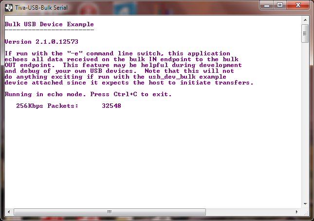

Bulk USB windows client RXD data only when user must first type characters?
Guru 55913 points
Other Parts Discussed in Thread: EK-TM4C1294XL
Custom USBprintf() will only print character to the Bulk client example after a string of characters is first sent to the host TM4C OTG USB device.
Surly that is not a bulk data transfer client or the intent of the name given the USB Bulk client and not so bulk software example?
In Bulk USB example the user types single (x) character echoed back in upper (X) characters. How disappointing to see an Bulk USB driver interface example that doesn't work with bulk USB data transfers.
Update 07/24/15: The Bulk client has a switch (-e) used to enable RXD data counts and speed of the bulk data transfer from the Target host..
Basic change to UARTprintf() coded driver:

  • Actually the title of the SW client if taken as true implies a bidirectional data transfer in Bulk form via the USB port.
    Why do we have to waste time installing all the SW then find the title given the client is no where close to what it even is or does.
    We call that fudging the truth or Fluffing and this not so Bulk client appears to be full of that.
    The client exhibits the ability to translate lower case keyboard entries and echo them back in upper case.
    A better name would be USB keyboard echo client then we wouldn't feel cheated by the example.
  • Unknown (still) is your, "breaking of the software loopback" as Amit suggested...

    BP101, keep in mind that the purpose of such demonstration programs is to illustrate how the HW/SW work not to provide a high performance implementation for you to use. Your other option is to but high performance implementations from someone.
    Robert
  • You need to modify the window code indeed, the code that TI provide you is only a echo application. But if look at the TI code furnish on window you got a USBwritePacket and USBreadPacket. There is nothing preventing you from only using USBreadPacket.
    By default ti, give you the following pseudo-code:
    WritePacket
    ReadReturnedPacket.
  • Eureka someone is actually paying attention to the simple question being asked. The award goes to Mathieu L. - the Question has been answered! Thanks Mathieu and hope VS2k5 will import the Bulk project client, have had it refuse to import later projects.
    Just to note that Amit provided the same answer in his first response, admittedly not quite as step by step.

  • To b Echo mode or not to be echo mode would have been a far better answer:
        // Are we operating in echo mode or not? The "-e" parameter tells the
        // app to echo everything it receives back to the device unchanged.
        bEcho = ((argc > 1) && (argv[1][1] == 'e')) ? TRUE : FALSE;
        // Print a cheerful welcome.
        printf("\nBulk USB Device Example\n");
        printf(  "-----------------------\n\n");
        printf("Version %s\n\n", BLDVER);
        if(!bEcho)
            printf("This is a partner application to the usb_dev_bulk example\n");
            printf("shipped with TivaWare software releases for USB-enabled\n");
            printf("boards. Strings entered here are sent to the board which\n");
            printf("inverts the case of the characters in the string and returns\n");
            printf("them to the host.\n\n");
        else
            printf("If run with the \"-e\" command line switch, this application\n");
            printf("echoes all data received on the bulk IN endpoint to the bulk\n");
            printf("OUT endpoint.  This feature may be helpful during development\n");
            printf("and debug of your own USB devices.  Note that this will not\n");
            printf("do anything exciting if run with the usb_dev_bulk example\n");
            printf("device attached since it expects the host to initiate transfers.\n\n");

  • Thanks Amit, Do see it there - had expected it to be in the downloaded client project files.
    BTW the -e switch shows only the USB speed and packet count yet the Windows client code seems to be written polling in a RD/WR buffer format.
  • Hi Mathieu,
    Case you want to try USBprintf() with the Bulk USB client the code to do so is posted below. Simply cut and paste UARTprintf() into Bulk_Dev client and modify a few lines with USBbufferWrite() and your in business. Thanks again for the tip and VS2k5 could import client once edit version 9 to 8 in the VSCproject file. May need to later add buffer status flag returned in USBBufferWrite() that checks the RingBuffer char remaining.
    With the UpdateThrougput() enabled it prints out text at an average of 4kbps to the bulk client. Don't forget to add the (-e) echo switch to the Windows shortcut! :)
