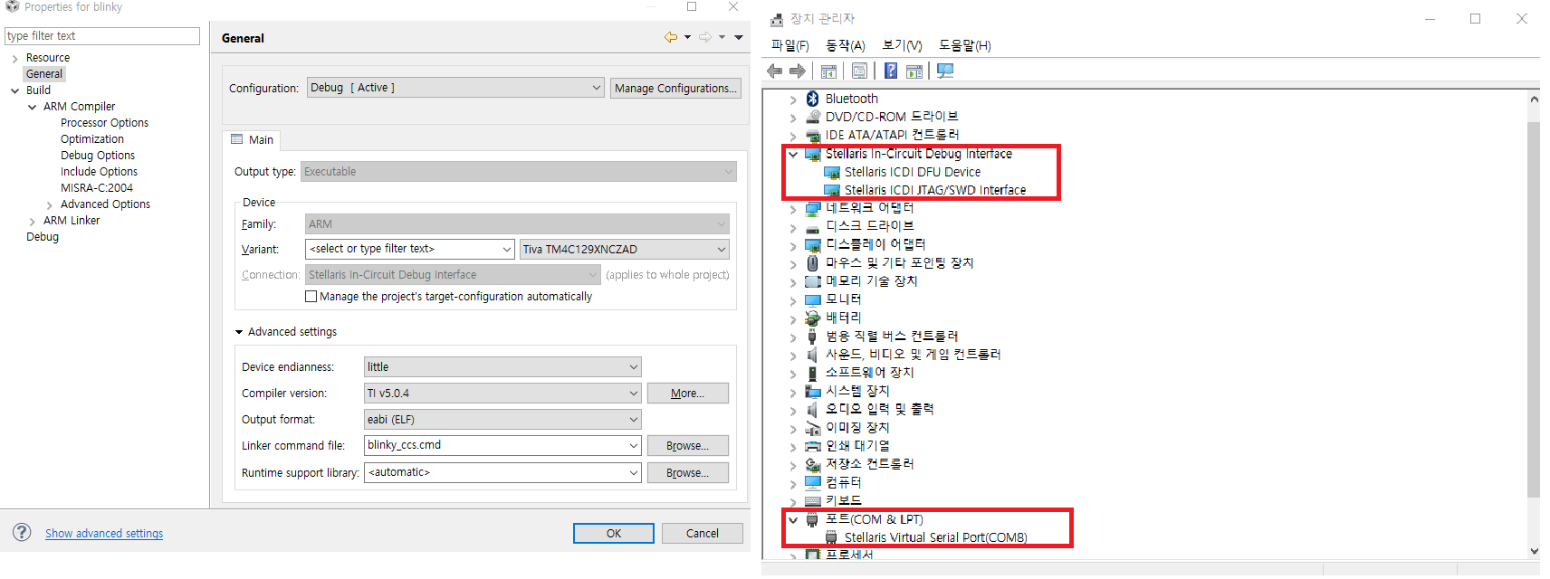

I started to work with  TivaTM DK-TM4C129X
But i have some problem. When i start debug button, Consle display <CORTEX_M4_0: Error connecting to the target: Timed out while waiting for target powerup/polling a hardware resource> to me.
i  use the ccs example project(blinky) that in included in tivaware-C-series 2.1.0.12573
Also, i have used ccs tool (version: 5.4.0.00091 ) and i installed driver
please help me and comment to me. thank you.
  • Hello Taekin,
    Did you try to program the DK-TM4C129X board using LMFlash Programmer?
    If yes, then please share if that was successful.
    If no, then try to program an existing binary from TivaWare into DK-TM4C129X board, using LM Flash Programmer. LM Flash Programmer can be downloaded from www.ti.com/.../lmflashprogrammer.
    Also share the "Debug Configuration" that is being used when you start debug.
    If you starting new development, then I would recommend that you use the latest version of TivaWare and CCS.
