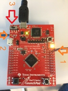

  • Hello Mark,
    I connected a 5V (arrow 2) and GND (arrow 1) from a 5V bench supply. The switch (arrow 3) is in device mode. I am able to flash qs_rgb example and get it to work no matter how many times I power it ON-OFF-ON (at least 6 attempts).
    Amit

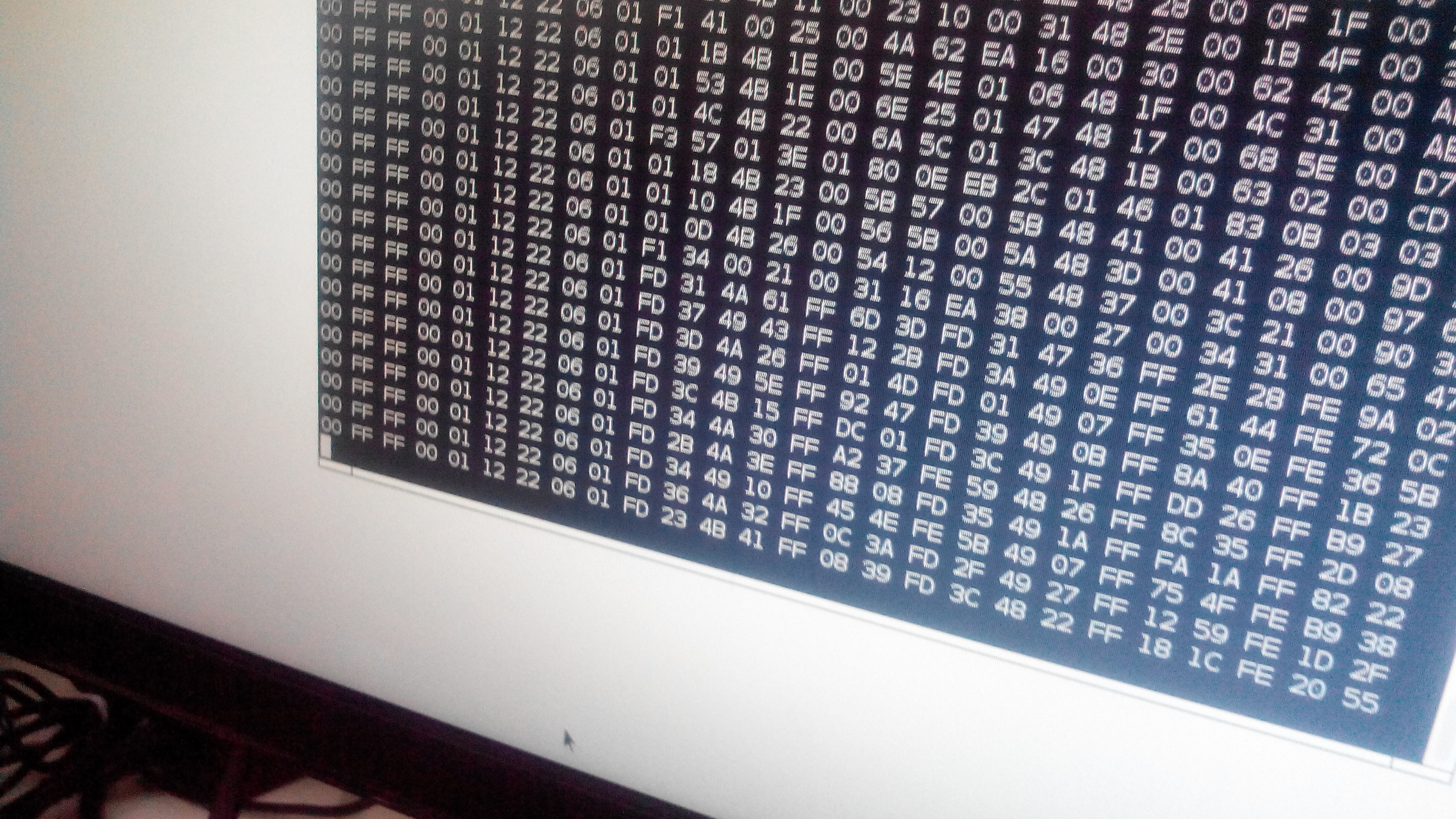

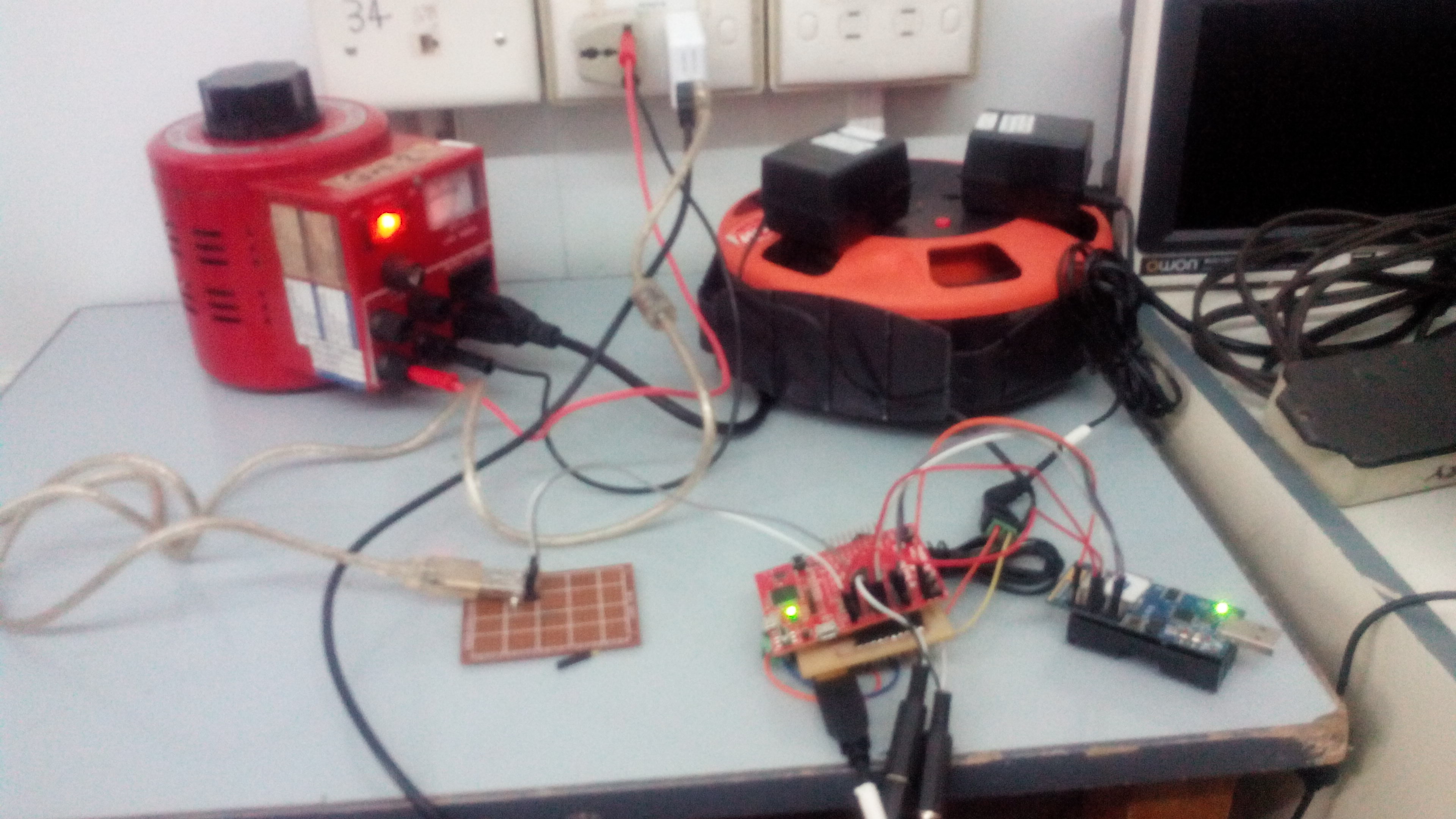

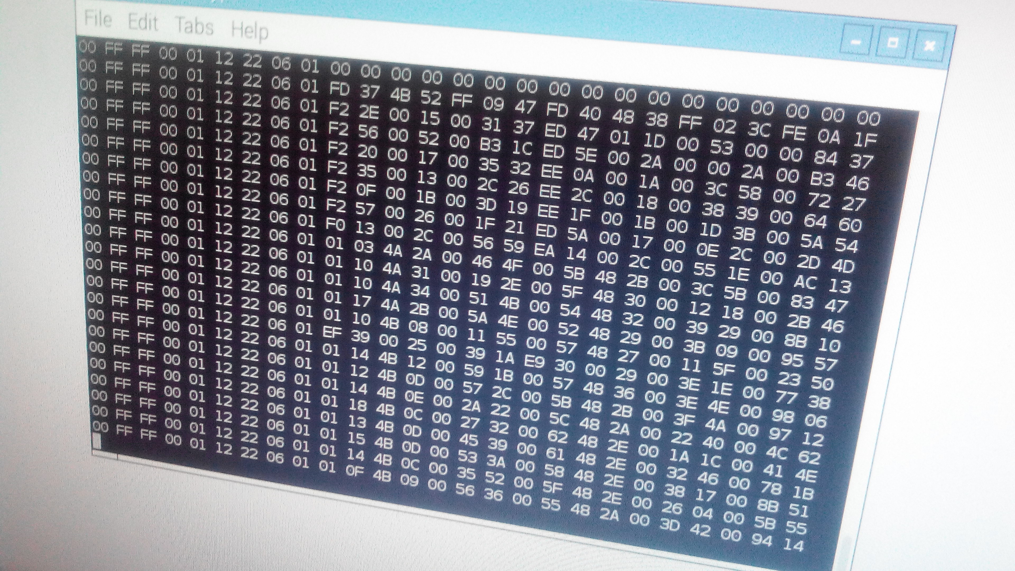

  • Hi all,
    We've been trying to solve our problem using everyone's suggestion so far.
    The following is our setup here.
    The small adapter in the outlet converts 220V to 5Vdc. It has two USB ports. Our Tiva has a conditioning circuit that converts the voltage transducers output to a range of 0-3.3V for the ADC. We introduced an offset in that circuit to prevent negative-valued voltages and make the minimum value to approximately 0V. That is the black USB connected to the white adapter providing a 5V source for the conditioning circuit. The whitish USB cable is used for Tiva's supply. The blue device beside Tiva is a wireless sensor mote used for transmitting Tiva results to a computer.
    When we switch to debug mode, everything is working fine. The result displayed in the IAR (the IDE we used, debugger is Stellaris, and the values are in decimal) and the results sent over by the wireless sensor (in hex) are the same. Just look into the the hex value that says "01 then FD", the value is "FD" or 253V.
    Before I came to this forum, the result we've been seeing is that the values displayed is smaller than is expected (based from the raw output of the ADC - we even checked the values before and after ADC gain and offset corrections are performed). The value from the IAR and the wireless sensor is still the same but from values ranging "DE-FD" it became "01 or 02" (previously it was "21 or 23"). We just neglect the rest of the numbers so as to be simple.
    Anyways, setup#1 involved Amit's suggestion that he provided with a picture. The switch is in device mode. The ground pins from the either set of headers in Tiva are connected. The Tiva is running and the code is running; however, the result is still that set of low-valued numbers - nothing changed.
    Setup#2 involved cb1's suggestion of powering the Tiva through the J3-1 pin (Vbus) and the J3-2 pin (GND). The switch is in device mode. The result is still the same.
    Setup#3 involved Atilla's suggestion. This part is kind of blurry because I don't understand the way he wanted to ground the Tiva and the external supply. So we open up the microUSB and shorted to ground the pin (pin4, I think it's the shield pin) beside the ground pin. We didn't use the data lines. The setup is similar to cb1's. The result, however, didn't change.
    All of the suggested setups allow the Tiva to run and the wireless sensor drawing power from Tiva also run properly. However, the results being displayed in both the IAR watch (using Stellaris debugger) and the wireless mote terminal are the consistently equal but not correct.
