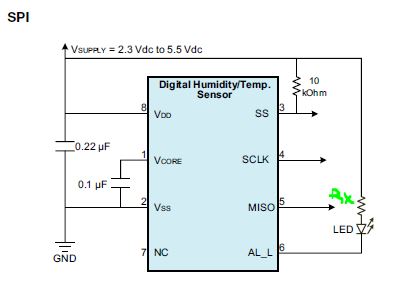

Hi everyone, I'm working with a TM4C123 here to connect a HIH9000 temperature and humidity sensor through SPI. I've received the sensor today and I just realised it is half-duplex, and that I just connected MISO pin on the sensor to SSI1Rx on my microcontroller. Since I need to send a command to the sensor to MISO pin, my first doubt is, can I connect directly SSI1Tx to SSI1Rx? So I'm able to send the command to MISO pin, and receive through Rx pin.
I would appreciate any comment on this issue. Thanks!

  • I've not read your device's data-sheet - yet will make "general" comments - usually found helpful:
    • it is unusual for any non-MCU, SPI device to assume the role of "master."   (I'd ask you to consider, "Just how this device can determine when & what to send to it's "slave?")   I don't believe it is intended as a slave.
    • MISO (pin 5) of that device will transfer data (send data) to your MCU's SSI_Rx pin - I believe.
    • SCLK (pin 4) is unlikely to be self/slave generated clock - instead is (far) more likely to RECEIVE data from the (real) master - your MCU
    • SS (pin 3) again is likely generated by the master/MCU
    • Two of your three direction arrows (signaling output) are reversed - to my mind.
    Might I be wrong... (again?)   By your diagram - w/all 3 pins (pins 3-5) temporarily "pulled-up" - would not a "Parade of SCLKs, SS, and MISO signals" appear - with NO effort whatsoever - upon your part?   That must be true if this device is a true master - must it not?   (pile of pre-"Derby chips" bets against your/other's representation of HIH as master)
    Again -
    • reverse 2 of those 3 arrows -
    • agree that there is NO Data (input) to this slave device (HIHx) -
    • properly drive SS & SCLK from your MCU (MASTER)
    and
    • observe MISO emit data (all by itself) in response to SS & SCLK from your MCU (which IS and REMAINS) the MASTER.
    Enjoy your SPI "Slave..."
    [edit] 13:55CST - It's hard to note the unusual font & green color you employed to mark "R/W" (I think that's what you marked) @ MISO pin.  (pin 5)   That "shared" pin would invalidate this chip as a TRUE SPI device - in my experience.  (and your attempt @ highlight failed due to the unrecognizable font!)
    Your attempt to employ the MCU's (or any MCU's) SPI function may be defeated here - as the necessity to first "Put Data" will almost surely cause data contention w/the Slave device's Output signal!   I don't like that at all.
    If your heart is set on this device - and this device only - - I believe:
    • bit-banged GPIO for the TX Command from the Master (MCU) (separate GPIO from SPI_Tx) followed by "tri-stating" that GPIO
    • and that followed by (silent) "Put Data" (SPI_Tx driving only a load resistor) - SPI_Tx NOT connected to this device - is one possible, though awkward/inefficient, alternative.
    This is a very minority use - breaking (FAR) from "usual SPI standards" - and is not typically best means to quickly/easily gain wide market penetration!

  • Ok, it's Honeywell's usual parsimonious to just shy of pointless datasheet but it appears that
    It is SPI
    It is a slave device
    It's slow, check the maximum speed before using
    It just has no need for a MOSI line, it never receives data.
    Robert
  • Thus - as first argued here - TWO of the THREE connecting, signal lines must have their arrows reversed! (it is only the Slave's Data line which serves as an output.)
    Note that poster believed (perhaps still does) that he must, "Send a command to the MISO pin." Poster Robert's read challenges the requirement to (send) commands...

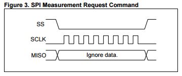

  • Thanks everyone for the replies. As robert and cb said, I misunderstood the Application note I was reading, believeing I had to send a command as I was doing with OneWire protocol with some other sensors. What it actually says if I keep reading is "an MR command is a read of eight or more bits":
    So I would believe that I rushed into creating this post instead or reading the datasheet and SPI app note carefully. I'll start checking this out and update this post when I'm done, just in case it's useful for someone else. And just in case I'm adding the app note I'm taling about.005 SPI Comms with Digital Humidity_Temp Sensors TN_009071-1-EN_Final_07Jun12.pdf
