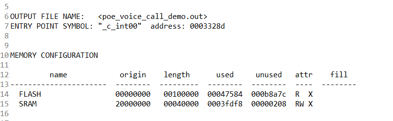

3. When the call from one board to another one is accepted - they freeze. Counters on both boards stay 0 and the touchscreens are not responding. I think it happens due to the lack of the Audio boards which I will get in a few days. So it looks like that (see picture). So and after only re-cycling the power helps to get the boards recovered.
So it is where I am now and hope Amit can help us and share his knowledge and experience to get it worked.
