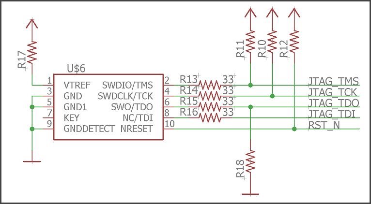

Validation of TM4C JTAG Header Selection and Design
I am building a TM4C123GH6PM board for personal home use, building my own drone :). I cannot find reference design examples of JTAG layout for any TM4C devices, and have the following questions:
Questions
  • Are there any reference designs provided for the Tiva TM4C JTAG connection?
  • Which JTAG device should I use?
    1. Just need programming, debugging and code-stepping for personal use
    2. I have picked use of the TI ARM JTAG Device, using the 10-pin connection, which makes use of the following TM4C pins (as listed in sec 4.3.1 of the datasheet):
  • Is the following layout correct, including VCC, GND and pull-up usage? (only JTAG wiring shown here!)
Is anything missing here, in the JTAG device selection and layout?
