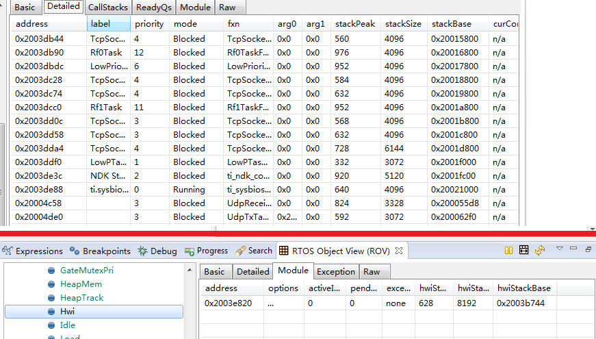

  • I found this issue could not be caused by stack overflow, because all stacks are below the address for the variable for BIOS type (ti_sysbios_BIOS_Module__state__V.threadType). In my map, the variable is at 0x2003EA44 (I can see "2003ea30 ti_sysbios_BIOS_Module__state__V" in the map file, and I also confirmed the address during debugging). The following is the snapshot for task and HWI stack in ROV, which show all stacks are blow the address.
    So definitely stack overflow will not modify the value for this variable.
    So then I think the issue could be caused by:
    1. Hardware issue. Is it possible?
    2. Things like dangling pointer that modifies RAM unexpectedly.
    3. A bug in BIOS code that doesn't set the variable expectedly.
    By the way, I have enabled HeapTrack for both Heap I am using (default and SDRAM), and no error related to heap track is raised.
