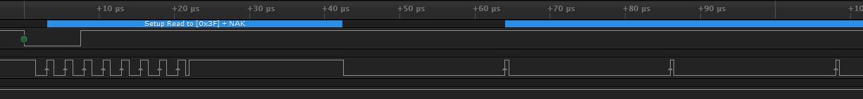

I have attached the TM4C1294NCPDT datasheet for reference into the following issue as well as the ADS7142 datasheet.  The following code should place the ADS7142 in Manual Mode scanning CH0 only.  However, stepping through the code in Code Composer Studio is showing that the master MCU is losing i2c bus arbitration for whatever reason.  This error does not seem to make sense in a single-master system but it is the error since my error check routine in the code is where the debugger is getting stuck.
On pages 1291-1293 are the Master Tx/Rx software flow charts I have used to develop the three functions I call in main.  The code is getting stuck inside the first call of ADS7142SingleRegisterWrite().
Any insight as to this problem is appreciated, thanks

  • Hi William,
    Just noticed you are at 400kHz now too via the new capture (above code doesn't reflect this), is the issue occurring at 100kHz?
    I am not sure the situation matches what would be resolved by 1. as from your capture it doesn't look like the slave is holding SDA but rather that the SCL signal is being stretched.

    Can you get an oscilloscope capture of the SDA and SCL lines so we can see the exact signal behavior during the fail condition?
    Also, if you have it working at 100kHz, a scope capture of the correct operation would be useful as well.
    From the captures it looks like the master releases the clock which would only make sense if it thinks it lost arbitration on the 8th bit that was sent out. This could indicate issues with noise or the ground reference. Given it's a BoosterPack and LaunchPad, the connections shouldn't have such issues though, which makes this an interesting case. I think the scope captures will best help clear up what may be going on.
    Also just as a sanity check, have you verified that the BoosterPack slave address is set in software correctly and also outputted correctly until the arbitration occurs? I am wondering this because the slave address looks different between your working and non-working captures?

    I just tried a different set of the same hardware (different launchpad, boosterpack) and I receive the same error.  The clock SCL is indeed running at 400 kHz.  As per the sanity check, yes I have checked it multiple times: the slave address of the ADS7142 on the boosterpack is 0x18.  What happens is the firmware takes the 0x18, left shifts by 1 bit to provide the Read/Write bit following the device address. So the device address is actually 7 bits followed by read/write.  The salae analyzer instead reads the 0x18 as an 8-bit address thereby showing 0x30 when setup for write, and 0x31 when setup for read.  So the analyzer does not properly place the read/write bit following the 7-bit 0x18 address.
    I will send you the latest analyzer screen shot of the error.  Thanks
    Will
  • Hi Will,
    Interesting, if you look at the Saleae Captures for the failure case though the Master seems to hold SDA high for too long then, right? I think scope captures may be useful to see what is going on there too. Because by your description SDA should drop by the 5th clock cycle, but it remains high throughout the process... that would indicate an issue even earlier than the arbitration point.
  • Funny,
    I just emailed you making the same observation.
    Will
