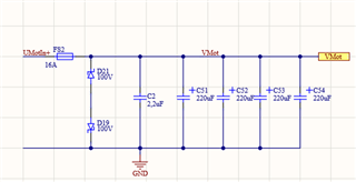

Schematic:
Used variant:
Half-bridge schematic:
Power-in stage:

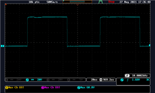

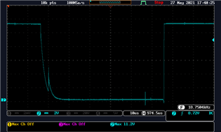

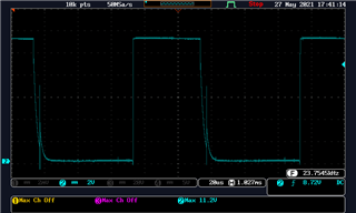

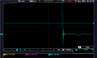

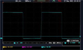

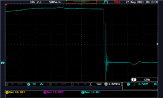

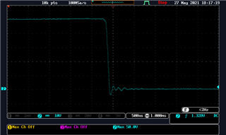

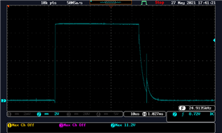

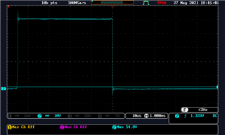

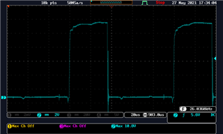

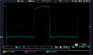

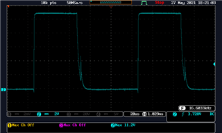

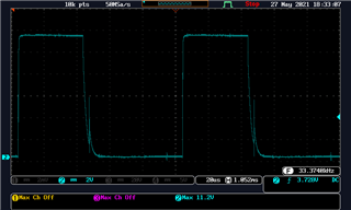

  • Hi Matt, I haven't done this yet but I have captured the waveforms (DS, GS, GGND of the hi-side and lo-side FETs) of 3 differently configured PCBs. Please consider:
    PCB1 (1000mA src/2000mA snk, untuned snubber):
    We can drive the motor reliably at a lowered Vsupp (30-32V). Alternatively if we start the motor at a lowered VSupp and increase this to 48-56V no issues occur, although sometimes the FAULT-condition still triggers. The waveforms were captured using this method.
    If we start the motor at 48-55V the FAULT-condition triggers instantly.
    Hi-side MOSFET VDS:
    Hi-side MOSFET VGS:
    Hi-side MOSFET VG - GND:
    Lo-side MOSFET VDS:
    Lo-side MOSFET VGS:
    Lo-side MOSFET VG - GND:
    PCB2 (450mA src/900mA snk, untuned snubber):
    Hi-side MOSFET VDS:
    Hi-side MOSFET VGS:
    Lo-side MOSFET VDS:
    Lo-side MOSFET VGS:
    PCB3 (450mA src/900mA snk, tuned snubber 23nF & 330R):
    We can drive the motor reliably at the required Vsupp (48-55V) without triggering a FAUL. The waveforms were captured using this method.
    Nonetheless the waveforms do not look that much different from the previous ones IMO.
    Hi-side MOSFET VDS:
    Hi-side MOSFET VGS:
    Lo-side MOSFET VDS:
    Lo-side MOSFET VGS:
    Sorry in advance for the overwhelming number of pictures but perhaps you could make something out if this data.
  • Hi Alexander,
    It's hard to see what is going on with only one trace at a time, can you take the captures with multiple traces and the fault pin on one screen so I can tell which shots were failing and which were not?
    Matt
  • Your high-side MOSFET Vgs in PCB1 (1000mA src/2000mA snk, untuned snubber) & PCB2 (450mA src/900mA snk, untuned snubber) showcase quite a lot of ringing. I assume this is when the fault occurs?
    Matt

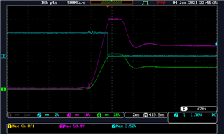

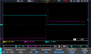

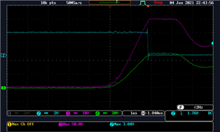

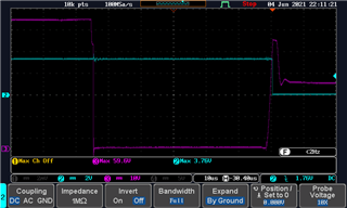

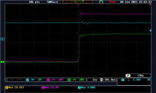

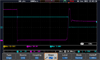

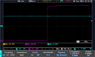

  • Hi Matt!
    We have captured some interesting waveforms which I think you will find interesting as well. Phases A & C look normal, but look what's going on when we take a look at B:
    SHB (purple) & nFAULT (blue):
    GHB (purple) & nFAULT (blue):
    GHB (green), SHB (purple) & nFAULT (blue):
    It appears that after a certain number of PWM-pulses (this number seems random) the phase B GH takes almost 2us to charge. These plots are after cutting the GHB trace and replacing it with a wire. Before this experiment the waveform looked idetentical.
    This capture shows the rising edge of a PWM period which did not trigger the nFAULT and where the rising edge is fast and clean. This is with the same PCB and same motor measuring the gate of the same B hi-side MOSFET.
    Very interested in your take on this!

  • A funny observation: If we disconnect phase B from the PCB we still get the same error, even though the waveforms look clean enough.
  • Hi Alexander,
    Thank you for the additional information! Matt and Michael are out of the office today but will try to reply in the next couple of days. Thank you for your patience!
    Anthony
  • Something thing else to consider, perhaps: an older version of the PCB works well despite featuring the exact same circuit with the MOSFET being the only difference. We use the FDBL86062-F085 instead of the IPT020N10N3ATMA1.
  • Hi Alexander,
    Thanks for posting all of the waveform pictures. I apologize about the delay getting back to you. Several of the team members were out of the office.
    Indeed, very interesting problem you're having.
    To summarize:
    - IDRIVE was lowered, however issue still persisted.
    - No issue driving the motor reliably at a lowered Vsupp (30-32V). If  motor is started at a lowered VSupp and increased to 48-56V no issues occur.
    - Starting motor at 48-55V, the fault occurs instantly.
    - Phase A and C switch fine consistently and faults never occurs, even at 56V.
    - The problem lies in phase B. GHB switches fine for some period of time, after that time a fault occurs. The fault occurs when the gate takes longer to slew, approximately 2us. I see that the fault occurs the moment GHB reaches its peak voltage.
    - On the 'good' waveform of GHB, we see the gate turn on <<1us.
    The FETS that you're currently using are the FDBL86062-F085 correct?
    If so, these FETS have a Qgd of 20nC. Try to aim for a risetime of 100ns-200ns. This would mean lowering your IDRIVE between 100mA src - 200mA src.
    Try lowering the IDRIVE one more time please. If this doesn't solve the issue, we can discuses further steps.
    Michael

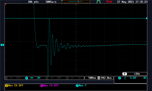

  • Hi Alexander,
    Looking at 6-th waveform from the top (Lo-side MOSFET VGS: for 1000/2000mA) we can see that it takes around 8us to fully discharge LS Mosfet gate charge. After around 4us from start of turning off LS Mosfet spike can be seen, caused probably by HS Mosfet turning on. That spike can cause turning LS mosfet on and crossconduction what may cause severe problems. Peak current gate drive time is 4us (plus 100ns of dead time) what would explain above mentioned timing.
    Is there anything like resistors,ferrite beads between the following points of diagram?
    GHX and GATE_HX,
    SHX and PhaseX,
    GLX and GATE LX.
    Grzegorz

  • Dear Grzegorz,
    No, the connections are uninterrupted.
    But also, yes, this spike something we noticed as well when we started our captures.
    Kr,
    Alexander

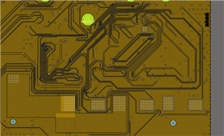

  • Dear Grzegorz,

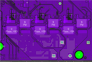

    Regarding your idea: when in current control we have no issues on the lower voltages and cannot even start the motor at 48-55V. So starting it slowly would not be possible. I will share the layout of this board and the previous iteration here:
    MOSFET drain-areas on the top-layer:
    MOSFET drain and source areas and DRV cooiling areas on inner 1:
    MOSFET drain and source areas on the inner 2:

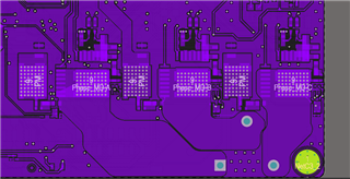

    This is the gnd-layer and my most controversial decision. I needed to increase the cooling areas underneath the FETS. As you can see in the captures, the signals and waveforms look ok despite this.
    The layout of the half-bridges on the bottom layer:
    The layout of the DRV8353RH on the bottom layer:
    A 3D-view as reference:
    The half-bridge layout of a previous, working, HW version:
    The DRV layout of a previous, working, HW version:
    MOSFET drain and source areas and DRV cooiling areas on inner 1 of the working HW version:
    3D-view of the previous, working, HW-revision as reference:
  • Hi Alexander,
    Thanks for all above pictures. First I will list all possible design flaws that I can find on first 6 pictures (not working board I assume).
    1. PhaseX/SHX traces (Inner layer 1) go from LS Mosfet drains to right side of PCB and seem to be very long -> high parasitic inductance
    2. Current sense resistors (Bottom layer) are connected to GND layers only with 3 vias - its not enough for 30A current! I would not use thermal reliefs for those vias.
    3. HS Mosfet gate traces change layers twice (increased inductance and reflections), they go far away from SHX traces what make inductance in HS Mosfet gate circuits very high (it works as a single turn coil), especially trace for phase B (Inner layer 1) goes left and takes very long way to DRV.
    4. Decoupling caps 2,2uF between HS Mosfet drains and GND, there should be 3-4 (or more) GND vias around GND terminals of those caps (or even inside capacitor pads, then its called via in pad). Parasitic inductance between those caps and ground plane (or LS Mosfet sources) should me as low as possible.
    5. DRV8353 - ground pad should be connected with thermal vias to ground plane/planes without thermal reliefs, DRV8353 can give quite a lot of heat and should be well cooled.
    Taking into account only 4 above mentioned flaws I can say it is quite a bad design. At first look the older working version is not much different. Making a board without those flaws doesn't guarantee proper working of circuit but it would be a good start to solve any potential problems. I think you have a few options:
    - try to make work new boards with some simple fixes, it might be possible
    - try to use older design, possibly make some improvements, an easier option
    - design a new board preferably based on some working example like evm board. I think it would be the best option. With currents of 30A I think you would be able to use non-splitted ground design like two designs above (for higher currents splitted ground design may be needed, but I don't have experience in that area).
    There are a few rules that I try to stick to:
    - keep traces between H-bridge and DRV short and quite wide, do as little layer changes as possible
    - keep SHX and GHX traces close together to minimize inductance (they form something like differential pair)
    - keep as many traces as possible on the same layer as DRV, DRV ICs usually are designed to facilitate such routing
    - keep low signal traces for DRV far away from its high power traces, DRV ICs usually have separate sides for low power and high power terminals
    - use inner layer closer to Mosfets as ground plane with as little holes as possible, it helps to spread heat from traces on Mosfet layers
    - use another inner layer as ground plane as much as it is possible, again better heat transfer and it provides reference ground for traces that changes layers
    Once you decide how to proceed with your design I can try to help you as much as I can.
    Michael may give you some answers as well.
    Grzegorz

  • Hi Alexander & Grzegorz,
    After reviewing with the team, we believe the root cause of this is a layout issue. See Grzegorz post above as he made several good points (specifically points 2,3,4).
    Have you tried swapping the FETS from the old board to the new board & to see if the fault condition goes away?
    There are not many vias under the sense resistor, we suggest that you add more of them if your next design if possible.
    However since the old board worked fine, and had the same amount of vias, this has us confused.
    Let us know how you plan to proceed after trying to implement some of our suggestions.
    Michael

    Something that keeps bugging me is the little spike on the falling edge of the lo-side MOSFETs which we keep seeing even if we disconnect the FET and measure on the wire soldered directly to the pad/trace of the DRV.

    Also, we have tweaked our RCD-clamp and now our most powerful motor seems to work fine, it's the smaller ones that are acting up now.
    Kr,
    Alexander
  • Alexander,
    Rsense GND vias - their number is to small for 30A current, they may work for a while with no problems and then burn or give a lot of heat in the best case scenario, 10-15 of 0.3-0.4mm vias should do the work.
    "bypassing the VGx with short wire jumpers as well" - I guess you meant GHx and SHx traces, it may help or not (if that is a source of problems). Short trace is not everything, it should be well coupled with its return path, so I think GHx and SHx traces/wires should be close to each other. After adding wires it may be necessary to cut old traces at both ends.
     "is it possible that we won't be able to see the impact of these layout flaws in our design while measuring?" - I think it is quite possible; bad H-bridge power supply decoupling, influence of parasitic inductances in H-bridge itself can be easily observed while motor current is high. In case of Mosfet gate circuits I guess it will be more difficult (I have not experienced problems with layout of gate circuits myself yet). Long gate traces mean high inductances what mean high Q of possible resonant LC circuits (mosfets add C to those circuits), resonance may appear under some conditions and then disappear, probably you would need to monitor both ends of trace to be sure that everything is OK. Long badly routed (far away from return paths or/and changing layers with return path badly designed) traces act as antennas receiving noise as well propagating noise. I think the best way is to route gate traces the best as it is possible and hope that it is good enough.
    "Something that keeps bugging me is the little spike on the falling edge of the lo-side MOSFETs which we keep seeing even if we disconnect the FET and measure on the wire soldered directly to the pad/trace of the DRV." - if you could provide some more details, what pin of DRV, what exactly is disconnected, is driver working, is there any current flowing to motor, waveform would be helpful as well.
    Grzegorz

  • Hi Michael,
    So, we have tried connecting the shunts lo-sides to GND and bypassing the gate-traces separately, never all of them together. Neither measure yielded any positive results. Do you recon it's worth trying all of them together?
    And yes, after adjusting the RCD-clamp to 330r and 22nF we could complete a first 10hr long current control durability test with a loaded traction motor with very clean current and voltage measurements (which I can provide iuw). However the steering motor (the lighter one) still instantly faults.

  • Hi Alexander,
    Could you try to bypass all 100R resistors in current sense filters?
    Grzegorz
  • Hi Alexander,
    I would suggest trying all of them together. Good I'm glad at least one of the motors is working with no issues.
    Given that you are running two different motors you may have to tune the RCD clamp for each motor. Potentially try playing around with the IDRIVE settings for the new motor?
    I'm interested to see the good waveforms from the traction motor.
    Michael
