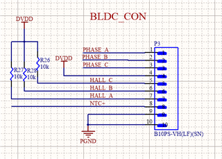

    I am Using the hall sensor in the Configuration shown in Figure 29. Also Please note that i am using Single ended Hall sensor, the NOT signals of Hall sensor are tied to 1.7V which is formed by using a Voltage divider between DVDD(3V3 in this case) and GND two Resistor of 10K 0603 Package which is also used in the DRV8306 EVM. I am using the bypass capacitor of 1nf 0603 package.
    I have Attached the Schematic for your reference Please let me know the problem.

  • My Hall Sensors are Open Drain they are pulledup using a 10K 0603 Resistor as shown in the Below figure

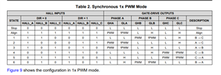

    C) I Have one Question why is the IC not generating NFAULT in one Commutation Cycle if the State of one of the Hall sensor is not Changing. This lead to the doubt that if PIN is damaged then does the IC skip the commuation steps as shown in the Figure.

    1)The Hall Traces are isolated from the Power switching planes and traces, Also the Hall sensor INPUT pin is NOT FLOATING it is pulled up using a 10K 0603 Resistor.
    2) As per above Schematic Diagram there is Bypass capacitor Present Between the Pin this Schematic is almost similar to the one used in DRV8306 EVM.

    Below is a table showing the various faults that the DRV8306 detects. So unless one of these faults occur then the driver will not report a fault. Our driver does not have fault monitoring for the hall inputs, so that is why there is no fault reported.
    What the driver does is it reads the hall inputs, looks up the appropriate output based on the hall values, and then applies the corresponding signals to the gate. So if one of the halls is held high, then the driver will only output signals based on the hall sensor signals, so there will be several states that will not be used. It is possible that the momentum of the motor will still allow the motor to spin even though it is not entering all the states. I would expect the motor speed to be reduced in this scenario, and I would expect the operation to be rough compared to normal operation.

    2) As you said the motor operates rough as those states Corresponding to the HALL INPUTS Are Skipped this is True Please Mention this in the Next Revision of Datasheet.
