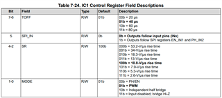

According to the datasheet both the SDI and SDO consist of 16 viable bits during transactions, SDI's first 8 bits define the operation (R/W) and the register address.
Our first small test was to read the IC1 Control Register who's default data should be 01010001 -> 0x51, correct?

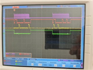

We didn't seem to receive the expected outcome so we've attached an oscilloscope for debugging.
CLK - Purple
SDO - Red
SDI - Yellow
CS - Green

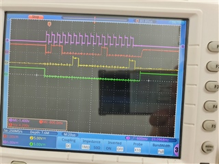

* Attempting to read IC1 Control Register's data, transmitting MSB 01000100 -> 0x44, correct?
Why was the response not 0x51? Did I do anything wrong?

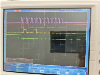

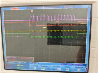

We figured we might as well attempt a write operation to the same register, transmitting MSB 00000100 -> 0x04, correct?
Then we noticed a weird pattern where the DRV8873 is just imitating whatever I'm sending.
Can I get your opinions on this? Am I doing something wrong or is the DRV8873 acting up?
