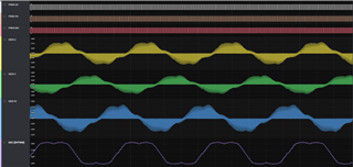

    We need to tie INLx = HIGH and provide INHA, INHB and INHC with MacDonald PWM waveforms 120 degrees out of phase with one another. Macdonald waveforms are PWM-varying profiles that create average sinusoidal voltages on Phase A, B, and C as shown below:
    The Macdonald waveforms create an average value of sinusoidal voltage with third-order harmonics from Phase to GND. These waveforms then get stepped up through the internal gate drivers and at the output, a sinusoidal voltage/current from Phase to Phase is produced.

    MacDonald PWM that you said is space vector PWM (SVPWM) right? First, I want to do and test simple, basic sinusoidal control with SPWM.
    Does this device not support SPWM? In my test code, DRV8316 works with SPWM.
    In case use SPWM with DRV8316, the relation ship of duty and average voltage is like this or not?
    (I use VM8.3V)
  • Kenji-san,

    Yes, this device does support SPWM. The DRV8316 is a Gate Driver and FET integrated device. This device can work on any type of commutation (e.g. SPWM, SVPWM). Yes, the MacDonald waveform PWM is typically used in space vector PWM (SVPWM).
    The information you sent lacks specification of which phases are being turned on/off. Is this PWM information on the left of the photo that you sent the input gate pulses or the output phase voltage?

  • Hi Johnny-san
    I referred the SPRABQ3 document, and write some test code.
    From the relationship between SVPWM duty and current waveform,
    duty > 50%: high side energization
    duty < 50%: low side energization
