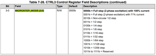

  • Hello, Art,
    The TRQ_COUNT is related to motor speed (back EMF); output current and resistance.
    It could be zero if the motor speed is low and output IxR is high. If the output resistance is higher than 10ohm, we may not see a good result.
    Please check https://www.ti.com/lit/an/slvaei3/slvaei3.pdf to get more detail.
    Right now, the microstepping setting is the full step mode. Would you change it to 1/16 or 1/32 microstepping setting.
    Wang Li
