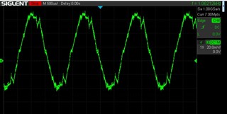

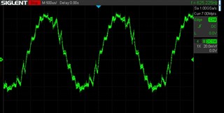

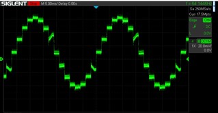

  • Hi John, based on the problem description of your application the torque count is jumping to near max count of 4095 when the motor RPM increases from 256 to 262. It appears to me ITRIP threshold may never be reached at 262RPM and higher speeds resulting in erratic torque count. We can confirm loss of current regulation by looking at the motor current waveform. Stall detection in the DRV8434S is based on ITRIP regulation in Smart Tune Ripple Control mode. Factors that affect the motor current from reaching ITRIP are VM motor voltage, motor coil DC resistance & motor coil inductance - L/R time constant, ITRIP value and step rate. Attached are examples at 1/4 micro stepping of good current regulation waveform and barely acceptable current regulation waveform for stall detection in the DRV8434S, and poor or loss of current regulation waveform. Loss of current regulation results in a sudden jump in torque count value from the working range abruptly, would be unusable and erratic for stall learning and detection. To resolve this issue the motor supply voltage can be increased to maintain current regulation at the desired step rate (keep in mind maximum VM specification of the device), use a lower time constant - L/R stepper motor such that current would rise above the ITRIP threshold fast enough at the desired VM voltage and step rate, or reduce the step rate to a level where the current regulation is acceptable for stall learning and detection.
    good current regulationbarely acceptable current regulationloss of current regulation
  • Thanks Murugavel, we have a current probe on order so we'll be able to take a closer look at what's going on with our current waveform soon. If we are losing current regulation, your advice seems to be the opposite of what Wang was saying. Increasing R or lowering L would lower the time constant (whereas Wang was suggesting lowering R), correct? I'll post our waveform when we have it.
  • John, You're welcome. Lower R defines the static current (peak) and it matters as well. L/R time constant defines the rise time. I just noticed you are using 48V VM already, sorry missed it last time. You are already at the top end of the operating voltage of the device. Your motor R is 14.5ohms. In contrast the NEMA17 motor I used for my testing has R of 2.1ohms per phase. I was able to drive the motor to little over 600RPM with torque count around 600 using 24V VM supply at 1/4 micro stepping with the DRV8434SEVM with proper stall learning and detection. It loses current regulation at around 638RPM and the torque count jumps to >4000. The phenomenon you experience is reproduceable and understood.
