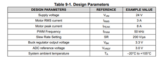

    thank you for suggestion, but I didn't explain it well in my application the pump consumptions in continuos operation is around 6A. So I readed on DRV8316 datasheet it works up to 3A in continuos conditions.
    I think DRV8316 is not a good choise for my project.
  • Hi Michele,
    If you are referring to Table 9-1, this is just an example application using 3-A RMS current. From an RMS perspective, I'd expect the device to be able to 8 / sqrt(2) = 5.66A RMS current, so if you need 6-A RMS, then you may need to use a gate driver device like the DRV8320.
