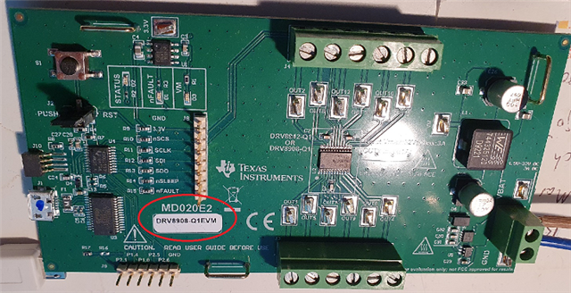

  • In Device manager it comes up as USB Serial Port(COM3) not as "MSP Application UART1) in the web interface and the local interface it comes up as I wrote before "COM3(FTDI)"  and since the integrated circuit for communication on the DRV8908-Q1EVM is of brand FTDI. I think the 3 different computers I tried it on detects the board via USB. If I disconnect the USB cable the it disappears.  Perhaps the DRV8908-Q1EVM board or the USB driver replies wrong name and has to be updated?

    There seems to be an issue with the GUI not connecting to the EVM. I tried it on my end and experience the same issue. We will look into this to understand what is causing the issue. Please give me two business days to research and I will get back to you with a reply by 6/28 or early.

    Can you confirm that the label on the EVM says MD020B. If it is, please follow these steps in order. I haven't had connection problems with these steps procedure:

  • My labels says MD020E2 and I tried the steps you suggested it doesn't work. I have also tried to do the steps in different ways but it doesn't help.
  • Hi Thomas,
    How did you obtain this board. The E2 revision is the pre-production board and the firmware is an older version that the current EVM revision. The firmware on the E2 board is not compatible with the current GUI which explains the issues. I had the same connection issues as you do but after updating the firmware the EVM is able to connect to GUI.
    Please order a new EVM from the TI store. Many other hardware changes were made to the latest revision so you should be using the latest board.
