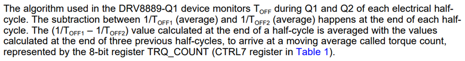

Regarding the stall detection, we consider that the timing is as follows, to help confirm whether it is correct:
The core stall principle (Hope to correct by you experts): 7.3.11.5 Stall Detection Chapter, (we think there is a relationship between the winding current of the stepper motor, the back electromotive force and the mechanical torque load of the motor)
It mainly depends on the phase of back electromotive force and winding current. The algorithm is TRQ_COUNT (CTRL8 Register) <stall threshold (CTRL6 Register)——Is this understanding right?

  • Jerry,
    Yes. DRV8889 reports a stall condition when TRQ_COUNT (CTRL8 Register) <stall threshold (CTRL6 Register).
