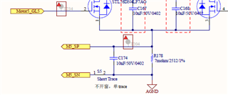

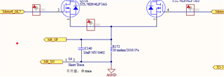

I use the 8718 to control four BDC,but different current on each H-bridge,such as 10A,2A,etc
the sample resistors are all connected in low side sense configuration ,how should i connect the PGND1 & PGND from the mosfet to the IC to get a more accuray diagnosis or protection funciton

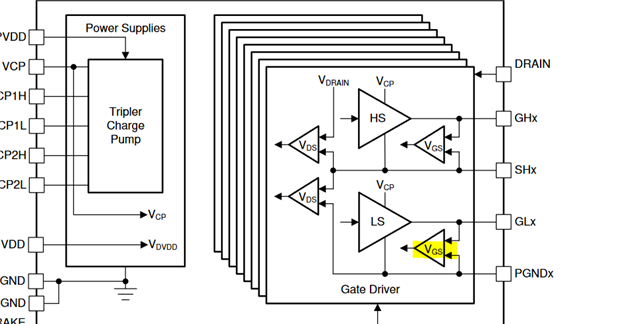

    Please connect the source of the LOW side MOSFET of half-bridge 1-2 to PGND1. PGND1 needs to be as close to the value of the source of the MOSFET since there is a VGS monitoring circuit that measure the voltage across the gate and source of the FET.
    However, the difference between PGNDx and GND should not exceed 0.3V. This means that the resistor value should be such that the voltage drop across it never greator than 0.3V.

    why the voltage drop between PGND and GND not exceed 0.3V. in fact,most of the time, it won't . if there is a common mode input voltage of Vgs comparator limited input voltage,but 0.3V is too low.

    The 0.3V maximum difference between PGND and GND is specified in the datasheet. The IC GND and PGND should be close in value to prevent offsets in the ground reference. 0.3V is the value that we have tested and analyze to be the maximum different between the grounds to make sure the device operates normally.
  • Hi Sheldon,
    I want to make a correction on my previous reply. The maximum difference between PGND and GND should be -2V not -0.3V.
