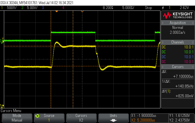

I am seeing a higher than expected offset error from the current sense amp outputs.  With VRef = 3.306V, gain set to 40V/V, SOA = 1.635, SOB = 1.664 and SOC = 1.638.  I can rerun the auto-calibration but always end up with similar results.
This is on a custom PCB connected to the analog inputs (A3, B3 and C4) of a TMS320F280049 microcontroller.  Things work but I am trying to track down a fairly significant current sense error.  I am measuring these offsets in firmware and subtracting from the measured currents but since this doesn't appear to meet the datasheet specification of +- 3mV I thought I should look into it.

    I would recommend testing the offset using the values on the EVM for the SOx output filters so we can eliminate the possibility of the filter values being the issue. The prior value I gave in the 1kOhms range was not correct, which was my mistake. If you have your series resistor value above ~50 Ohms, you should be in a good range to eliminate the possibility of error here.
    On a separate note, can you take a screenshot of SOx during switching in order to observe its transient performance? Since your capacitor is quite a bit larger than the EVM's, a worthy concern is that SOx needs to source quite a bit of current (for a lengthy amount of time) in order to charge up.

  • I changed the filter components to 56 ohms and 2200pF.  The DC offset remains basically the same.  I'm also not seeing a measurable difference when in manual calibration mode.
    VRef=3.307
    After requesting an auto offset cal via SPI and pausing the processor at a debug breakpoint the offset measure with a DMM:
    SOA = 1.640
    SOB = 1.688
    SOC = 1.639
    Putting the device in manual calibration mode and again pausing the processer the offset measure:
    SOA = 1.640
    SOB = 1.689
    SOC = 1.639
    The yellow trace in the plot below is SOC, green trace is INL_C.
