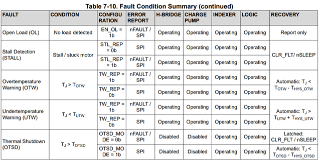

  In my project I am suing drv 8889 driver to connect stepper motor. I need to access the status register especially Fault and Diagnostic 2 register .But while reading these register I'm always getting a value 0×84 and 0×18 ,indicates motor stall condition. Could you please let me know why always getting stall condition flag even if the motor is in running condition.
And also we have tested the motor under temperature (-10).But the UTW is not changing to high.
Please clear my doubts

    Are you using your own board and microprocessor or EVM?  If you are using your own board, please send scope capture of the 4 SPI signals to verify what you are reading.  We have seen many times that timing issues result in incorrect data. Only way to verify is with scope captures.
    Also, what is the stall threshold set at?  If you change the threshold to a very low level, do you still get the fault?

    Less than -25C should indicate and UTW.  -10C is just a typical.  Minimum per datasheet is -25C.
    For stall, are you getting nFAULT = LOW.  Based on your register setting, if it is a real stall, you should see this.  Also, bit 5 in CTRL5 is the stall learn. On a successful learn, this will go back to "0".  Does it ever read "0"?

    Yes I'm getting STL_LRN=0 in CNTRL5 register and nFault =Low also , But the STL and STALL is not updating properly . Sometimes the STL and STALL are setting ONE even if the motor is in running condition .
  • Abhitha,
    Have you tried adjusting the threshold as I proposed before?  It might be that the "learned" value is too high and causing stall even under running conditions.

  • Hi Ryan , Thank you for your support . Stall flag is setting properly now since I have changed the STALL_TH . The under temperature flag yet to test and confirm
