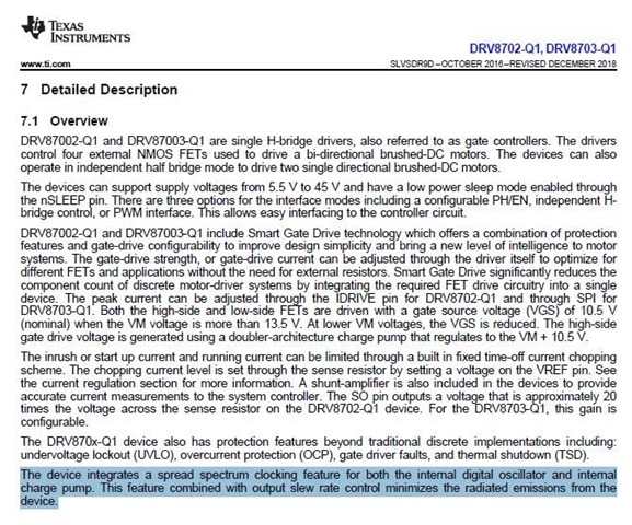

I would like to ask that do our DRV8703Q1 have the spread spectrum function? Since I have read the datasheet that the DRV8703Q1 has the spread spectrum function in datasheet below:
Here is a description about spread spectrum, but there is no specific method to enable the spread spectrum. Could you tell me that  if the chip has this function itself or how to turn on this function.
I think the spread spectrum has already enabled in side the chip  but we need your confirmation and guidance if we need to enable the spread spectrum function or not, thank you.
  • Hi Ziriu,
    You are correct. The spread spectrum function is already integrated on the device. There is no need to enable it externally.
    I hope this answers your question.
