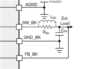

Please tell me the recommended processing method for the FB_BK pin and SW_BK when the buck regulator is not used.

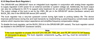

The data sheet has the following image, but it seems that there is no description about the recommended processing method when the buck regulator is not used.

  • Hello Koki-san,
    As the note recommends, external components for the regulator MUST BE POPULATED. The DRV8316 powers up with the regulator enabled and will not start up properly if these components are not in place.
    Matt

  • Hi Koki-san,
    1) Please use LBK = 22uH or 47uH, RBK = 22 ohm, CBK = 22uF. Buck or resistor can be used for LBK/RBK when buck is not used. We have seen customers use a 22 ohm resistor for LBK/RBK when the buck regulator isn't used.
    2) GND_BK can be tied to the DRV8316's thermal pad GND, SW_BK routes from the pin to LBK, and FB_BK routes from buck output back to FB_BK pin. See below.
