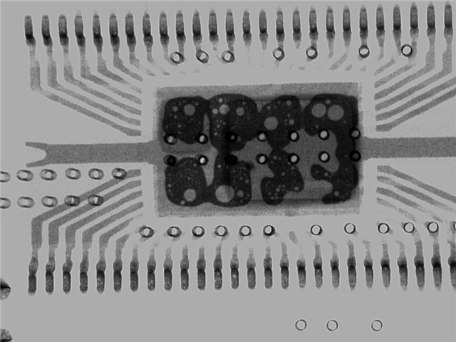

We just recently had a new production for our Motor controllers that are using DRV8302, this wasn't the first production and we had another production 6 months prior to the latest one and in the new production, we witnessed some new issues.
Please keep in mind that all the production line is automated and No manual or hand soldering was involved in SMD assembly of these boards.
- We witnessed around 25% failure rate in the production line after testing the boards due to issues with DRV8302, so to inspect it further, as the design was tested lots of times, and we never had an issue with DRV8302, we did an X-ray inspection for 6 sample boards as their images are also attached in this post, you can find the explanation for each below:

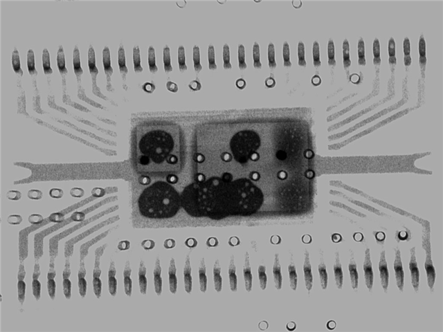

X1: It is the working sample right after the production for your reference, so we can name it the GOLD board.
X2 and X3 : samples without switching at the output, these two boards are just programmed right after the production and they failed to produce any output at the switching stage ( nFault is Low), the Buck converter works and we see the +5V output ( as designed for)

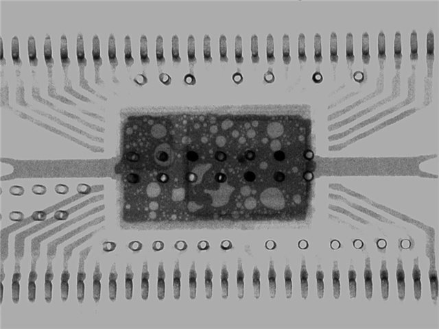

X4, X5 and X6: These are the boards that we witnessed the Buck converter is not regulating the voltage and the input voltage is appearing directly at the output, as a result, all the components connected to  this are sparked and destroyed. ( rare condition, maybe 4% of all the failed boards)
_ Test condition: all the boards are powered up with 50V at the input ( our standard test for all the boards)

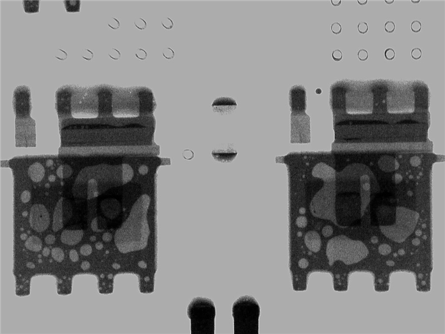

In all these Images, U1 is the DRV8302, and the Q3 to Q14 are the Mosfets connected to DRV8302 ( we used parallel MOSFETs on each side)
Based on my observation I understand the following:
for X1 ==> The soldering of the power pad is not great, but there is some sort of a return path for the ground plane ( still IMO this is not a good one), but the board works and DRV8302 doesn’t show any fault and we can see the switching at the output of the Mosfets, although I feel the Mosfets pads are not also very well connected and possibly the line impedance is not very low...
For X2⇒ the power pad connection is poor and it seems there is some sort of an island between the ground of the Buck to the other ground of the IC
For X3 ⇒ it seems the DRV is well connected but there is some sort of an issue with the Mosfets soldering…
for X4, X5 ⇒ it’s evident that the Buck converter doesn’t have a good return path or it’s insulated from other paths, so it can’t close the loop...
Now we are in discussion with our manufacturer and they are not very well convinced that the issue is with solderings while we previously manufactured the same boards with another manufacturer and we didn’t have this issue.
So I’d like to know what are the thoughts of the TI design and manufacturing team on this and have you ever witnessed such issues in production lines?

  • Hi John,
    Thanks for posting on the MD forum, sorry to hear you're having trouble with the device.
    With at 25% failure rate this may be an issue with your schematic/layout. Can you post your schematic so I can review it? (if needed I can review the layout too but let's start with schematic).
    Were you able to successfully spin a motor for a period of time before seeing the failure happen?
    I see that none of this was soldered by hand, and it was all done on the production line. For the units that are failing (X2-X5) have you tried to remove the units and clean them, clean the pads, and re solder the units back on to see if this resolves the issue? What if you put a brand new DRV8302 on (by hand)?
    We need to get to the root cause of what's causing the very high failure rate. Is it schematic related or is it production line related? That's what we need to figure out.

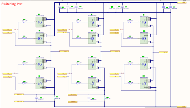

    Here is the Schematics for the DRV8302 and the Mosfets ( all the gate paths are done with length control, and the shunts are routed differentially)

    Some thoughts on your schematic
    - Since you are powering these boards with PVDD = 50V, it's best to have your bulk capacitance at twice the rated voltage of your input voltage. So I'm recommending C24,C27, and C32 get replaced with 100V rated caps. Since this power stage worked fine on your previous version of the board, I don't think this is an issue. However if there is ever a version 3 of the board, it may be worth changing.
    - I'm assuming this is a high current application since you're using MOSFETS in parallel. Was there any damage to the MOSFETS in these tests? I see you said the MOSFETS are still intact, I just want to verify I'm understanding that they are not damaged.
    - As for the DRV schematic, it seems like you followed the application section from the datasheet and it looks good.
    Thanks for the suggestion, but in faulty boards, we see the error regardless of the Bus voltage value, for instance at 24V or even lower than that, so I believe this might not be an issue, but yes, in the next iterations, we will consider increasing the voltage rating of those caps ( if the form factor allows us).
    For the boards you did replace the DRV and could spin a motor, were you able to spin a motor for a significant amount of time without any failure?
    Yes, it seems there were no other issues as soon as they started to work and they behaved like a normal board in all the conditions
    as far as I see, there is no diagnosable damage to the MOSFETs, both visually and operationally, meaning that the MOSFETs are not causing any short or overheating or excessive current drain, so I can imagine they are fine.
    I should say that since right after the Power up the DRV goes into fault mode, the MOSFETs are not switched at all, so there is a very little chance that they get damaged in this condition, as also there is no load connected to the board and there is no stress on the MOSFETs in initial tests.

  • Hey John,
    The packaging team got back to me with some feedback on the X-Rays you provided.
    The DRV8302 is a HTSSOP Power-Pad device.
    The datasheet includes a package drawing with PCB pad and stencil recommendation. Based on the images above, it seems that your stencil has 8 smaller opening instead of one opening. The datasheet suggest a stencil opening of 6.35 X 3.61mm with 0.127 thick stencil. Those holes are thermal vias, we suggest to plug or filled these to avoid solder wicking into the vias. During SMT, the package should release after touching the PCB, not release at the point when just touching the solder paste or free fall above the solder paste.
    I have attached an App Note for this type of package for reference. Here's the link
    I hope this helps, let me know if you have any further questions.
    Michael
