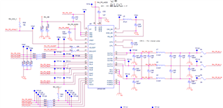

DRV8316: Operating issue & pin setting review
Part Number: DRV8316
The customer is testing using DRV8316.
The motor is not operating properly.
1) Is there any part of the environment that set wrong?
2) Please give me a guide to the minimum setting required to drive the motor.
Pin Setting
- nSLEEP : HIGH (5V), DRVOFF : LOW(0V), SPI settings (STATUS registers, CONTROL registers all initialize to data bit 0)
Output Voltage By Pin
-VREF : 3.3V, SOA, SOB, SOC : 3.24V, VM1~3 : 12.2V, Cp : 17.2V, AVDD : 3.3V, FB_BK : 3.27V, CPH : 12.2V
- INHA, INHB, INHC: Input PWM values according to motor pin map
- INLA, INLB, INLC: Input GPIO values according to motor pin map (HIGH, LOW)

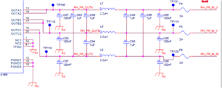

    Attached review of schematic here: drv8316_sch_review.pdf
    Is the motor connected to RH_FR_OUTx or after the fuses at RH_FR_M_x? What is the purpose of the added 2.2uH inductors, phase to phase capacitances, and phase to GND capacitances before and after the inductor? Is this supposed to just be filtering? We would not expect any components at the OUTx pins of the device that add extra impedance and inductance to the motor, or else this can make commutating the motor sinusoidally much more difficult.
    From the waveform above, looks like all outputs are trying to go high simulatenously when INHB = 25% and both INLA and INLC = on. For sinusoidal commutation, I would expect all three phases to have a duty cycle with synchronous PWM waveforms to avoid current recirculation through the LS body diode, or else this can produce higher switching losses. Another resource for sinusoidal control is here: https://www.youtube.com/watch?v=-By_vt27Xhs
    Could you try removing the inductances and capacitances on the motor outputs and consider running synchronous PWM waveforms for commutation rather than asynchronous, or consider using 3x PWM mode so that INLx can be kept at a 1 while feeding the INHx signals?
    If the buck is unused, can this be disabled through BUCK_DIS bit?
