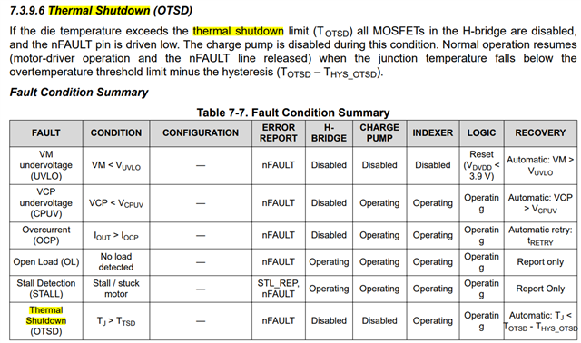

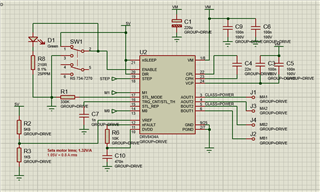

Hi there,
Having some issues with a design. We have the DRV8434A in a typical application with VM running at 48V. We found that after a while the motor would shutdown from over temperature. This wasn't too much of a problem, we lowered VM so the fault wouldn't occur so quickly, but even after this adjustment, we found that the chip wouldn't automatically restart once T has dropped (factoring in the hysteresis). Is there something fundamental we're missing?
