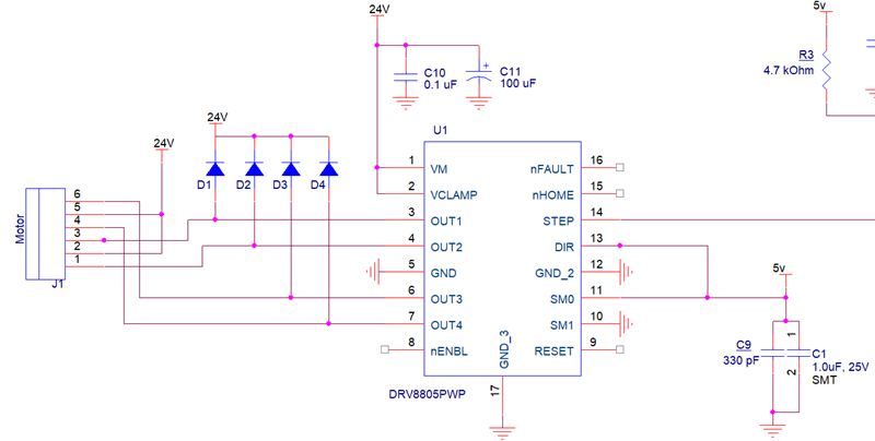

I have a DRV8805 chip driving an NPM PF35T-48B1 motor. It seems that when the motor goes thru a rotation, the steps look jerky and seems like the resolution should be improved so the rotations become smooth. Also, I'm supplying 5V on the DIR pin which should make the motor rotate clockwise but when I apply power, a lot of the time the motor turns counter clockwise. My questions are:
1. How can I smooth out the rotations?
2. How to I make the motor turn clockwise consistently?
I attached a video I hope you can view. The left unit is the one being driven by the TI DRV8805 chip.

    I have the DRV8805 set to half-step currently already. Here is the schematic for how I have connected the DRV8805 to the motor. I have this on a prototype board so the traces are set. The DRV8805 chip output is connected to the motor the whole time.

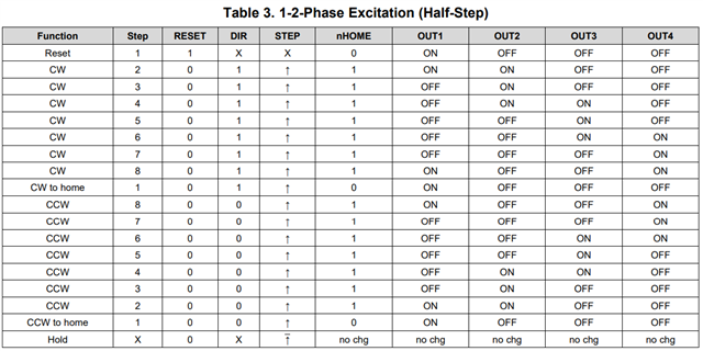

    For the spinning direction, we have to check the output following the table 3 or not. Please step by step send single STEP plus to STEP pin. The output should follow table 3 and run into one direction unless the DIR pin voltage is changed.
    I saw the video from the dropbox link. It is OK to me and the two motor spinning directions are same. If you want to more smooth, you may have to use "Wave Drive" option to control the output current and get a high resolution. It seems complicate because the host controller needs to control the current regulation point step by step.

    " So this tells me that the chip is outputting correctly following the table 3 steps. Am I right in thinking this?" I agree with you.
    Would you change the DIR setting during the motor spinning? Does the motor spinning direction change? After DIR setting change, do you see  the motor speed change?
    If the motor direction can be changed after DIR setting change and the output following the table 3, we should not see any problem.
    If the motor direction keeps same after DIR setting change, but the motor speed is different. I would think we may need to slow the motor before change the DIR setting.
    If the motor direction keeps same after DIR setting change and the motor speed is same as before, I would think we need to control DIR signal and nSLEEP signal startup sequence to make DIR voltage is stable before nSLEEP pin voltage goes high.

    Motor connection might be wrong, please take a look at post below. It looks like motor is connected according to first diagram.
    https://e2e.ti.com/support/motor-drivers-group/motor-drivers/f/motor-drivers-forum/550281/drv8805-excitation-procedure
    Grzegorz
  • That fixed it!! The rotation looks a lot smoother now too. Thanks so much!!
