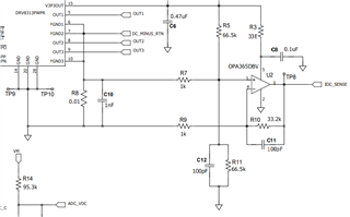

I want to know the ADC gain of current sense used for DC current sensing in DRV8313EVM design?
Is it inverting or non-inverting configuration?
What is the offset for the same?

Hi Prabhat,
The DRV8313EVM has an external, non-inverting CSA. It can be seen here on the EVM schematic (found in the "Design Files" located on this webpage (LINK)):
The gain of this external CSA on the EVM is 33.2. The output offset for this configuration is approximately ± 3.32 mV, and the current sense offset is approximately ± 10 mA.

Hi Johnny, by offset I meant that what will be the voltage output from CSA when the current is 0.
Hi Prabhat,
My apologies, I provided you with the expected offset error of this particular op amp in my previous post (± 3.32 mV). The resistor divider on the + pin of the op-amp biases the output at 1/2 of the 3.3V input since the two resistors of the voltage divider are equal. The output offset would be 1.65V.
