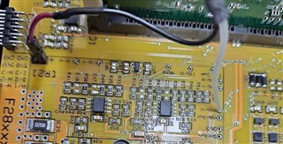

Hi, I'm currently using TMDSHVMTRINSPIN for my motor control experiment and am having some difficulty due to control cards(F28335) capability limitations of data acquisition rate of only 60kHz(using only one channel).
I would like to add an external DAQ to acquire phase current, terminal voltage and DC link voltage data which can sample data at a rate faster(over 1MHz) than the DAQ system embedded in the TMDSHVMTRINSPIN.
I saw there are ports(I'm not sure if I can call them ports but anyway) on the board as in the picture where I can connect wires to.

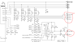

I see in the circuit diagram that I would be able to measure Vfb-U, Vfb-V, Vfb-W, Ifb-U, Ifb-V, Ifb-W, Vfb-BUS, and even PWM signals.
Are these ports meant for this purpose? or is connecting an external DAQ not recommended during operation?

  • It's a test point for connecting the probe of the oscilloscope. Please note that the high voltage kit is hot ground design, so we don't recommend to connect these ports to an non-isolation instruments directly. You might connect it to an external DAQ during operation if the DAQ is isolation connection.

  • Correct. The AC rectifier generates the DC voltage the ground of which is floating from the protective earth ground. Hence appropriate caution must be taken while connecting scopes and other test equipment to the board. Recommend isolation transformers must be used when connecting grounded equipment to the EVM.
