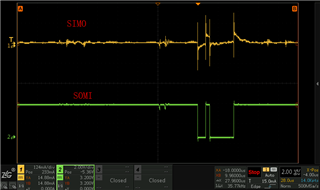

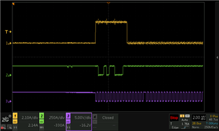

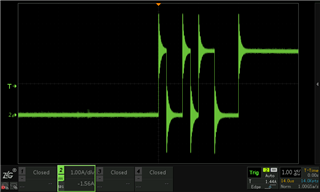

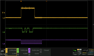

Hello,expert:
I am honored to have this opportunity to ask you a question. My experimental equipment mainly includes TI's F28379D launchpad + Boostl-POSMGR (encoder interface board).And the program I use is derived from TI , and its path is:D:\ti\c2000\C2000Ware_MotorControl_SDK_3_01_00_00\solutions\boostxl_posmgr\f2837xd. Because I thought the actual Tformat encoder CF ID I was using was different from the TI's sample, I changed this, but found the program stays at ESTOP0 inside the tformat_exCommands(void) function.As shown in the figure below, Figure 1 is DF of TI routine encoder(The encoder type isTS5700N8501 ).Figure. 2 shows the DF of the encoder I used.(The encoder type is TS5720N8401).Figure. 3shows My program is here to stay.
              Figure 1 TI sample(TS5700N8501 )

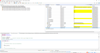

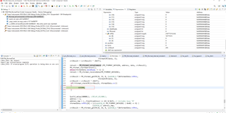

The following is TI source code:

               Figure. 3.My program is here to stay.
The program I modified mainly consists of four functions.
uint16_t PM_tformat_setupCommand(uint16_t tformatDataID, uint16_t eepromAddr, uint16_t eepromData, uint16_t crcSend):                                                                                                                               1.  Change the value of receiveClks
 2.  Change dataReady value  0 to 1
 uint16_t PM_tformat_receiveData(uint16_t tformatDataID):
 1.Add the code:tformatData.dataReady = 0;
 2.Modified the tformatData rxPkts
uint16_t tformat_exCommands(void)  and main function loops while:Modified the crcResult
The details are shown as follows(The yellow part is the modification):

    1.I have changed the encoder to TS5700N8401 (tFormat supported)
    2.Check the signals coming out from the C2000(I can detect the waveform, but the waveform looks a little strange):
        a.TxEN waveform(It seems too narrow):
        b.SPICLKB waveform(SPICLKB is 2.5 MHz and the bit-width of DATA_OUT is 400ns):
        c.DATA_OUT (SPISOMIB):
    3.During the test, I used BOOSTXL-POSMGR throughout the test
    4.By measuring the waveform, I can confirm that it is set SPICLKB is 2.5 MHz and the bit-width of DATA_OUT is 400ns.
    Please help to check the above waveform, thank you!
    In addition, I noticed that the waveform described in another of your posts is different from mine.
    e2e.ti.com/.../3469334
  • Thank you for the information.  I will review and get back to you by the end of the week.

    Thank you very much for your previous reply. I have some new discoveries to share with you.
    I changed the probe for the test, and the waveform looks a little similar to the waveform in your other post, as follows:
    Txen(GPIO9) is yellow   ;   SOMI(GPIO64) is green;   CLKs(GPIO7) is purple
    but,I find the purple waveform is different from yours.
  • In the related post, I had modified the code to repeatedly send a command.  Without that modification, the code will send one command and then wait for a response from the encoder.  I think this is why you see a difference.
    It looks like commands are going out fine.  The encoder isn't responding.  The next thing I would check is that the encoder is getting proper power.  I have seen some issues powering an encoder from the booster pack.  Try bypassing the card for the power and sending it though an external supply.

    As you did above (using an external power supply), I've got the same waveform as you, but the code will still be: while(tFormatData.dataready!= 1);/ / {}
  • Lori,
    I am referring to your relevant post to modify the command, and the modified part is as follows:
    // retVal1 = tformat_exCommands(); <-- comment this out
    while(1)
    retVal1 = PM_tformat_setupCommand (PM_TFORMAT_DATAID3, 0, 0, 0);
    PM_tformat_startOperation();
    DEVICE_DELAY_US(40L); <-- some delay
  • As you did above (using an external power supply), I've got the same waveform as you, but the code will still be: while(tFormatData.dataready!= 1);/ / {}
    That is strange - with the code change the processor should stay within the while(1) loop you added and continuously send a new command instead of waiting for a response.
    I'm starting to run out of ideas - it seems the C28x is doing the correct thing  (without the code modification):

  • Lori,
    You may have misunderstood me. After I got the same waveform as yours above, I thought I could confirm that C28X could work normally. Then I modified the code to get position information, as shown below:
    while(1)
    retval1 = PM_tformat_setupCommand (PM_TFORMAT_DATAID0, 0, 0, 0);
    while(tformatData.dataReady != 1) {}
    retval1 = PM_tformat_receiveData(PM_TFORMAT_DATAID0);
    crcResult = PM_tformat_getCRC(0, 40, 8, (uint16_t *)&tformatData.rxPkts,
    tformatCRCtable, 5);
    crcResult = crcResult ^ (0xFF);
    if(!tformat_checkCRC(crcResult, tformatData.crc))
    ESTOP0;
    //Invert the received bit sequence for position and
    //turns for actual data
    position =
    ((__flip32((uint32_t) tformatData.dataField0) >> 24 ) & 0xFF) |
    ((__flip32((uint32_t) tformatData.dataField1) >> 16 ) & 0xFF00) |
    ((__flip32((uint32_t) tformatData.dataField2) >> 8 ) & 0xFF0000);
    turns =
    ((__flip32((uint32_t) tformatData.dataField4) >> 24 ) & 0xFF) |
    ((__flip32((uint32_t) tformatData.dataField5) >> 16 ) & 0xFF00) |
    ((__flip32((uint32_t) tformatData.dataField6) >> 8 ) & 0xFF0000);
    DEVICE_DELAY_US(400L);
    In addition, I found that it is possible that the waveform of SIMO (yellow curve) is not correct.
  • Yes, I agree SIMO looks very noisy.
