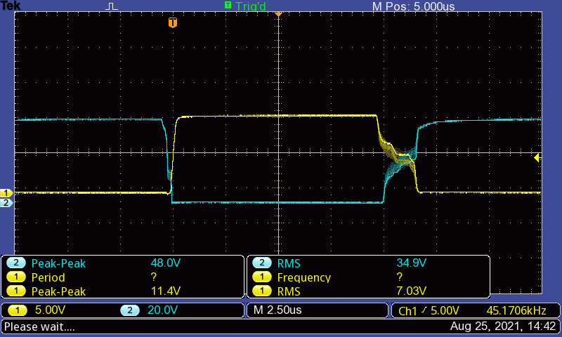

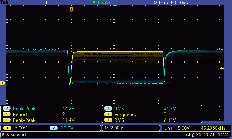

    I add some oscillograms (the power supply is at 32V in this setup):
    This is Highside/Lowside gate before the motor starts spinning (again lab 1b which is voltage control just to verify the design)
    And this is what I see when the motor starts spinning:

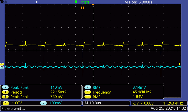

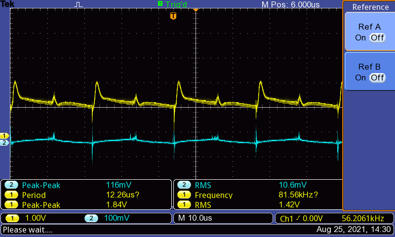

    Also this is the current measurement on the SP pin (blue) and SO pin (yellow) on the driver:
    5V/V gain:
    40V/V gain:
    Edit 2: Well, after detailed inspection I noticed the SOB and SOC pins shorted together hence the reason current loop control did not work. But the questions about the gain, motorware setting and the gate voltage behaviour remains.
