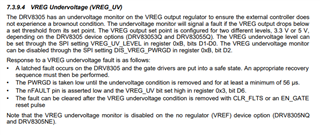

    Thanks for posting to the forum. Which device did the customer try as a replacement on their board? On the customers board what is the reference voltage connected to the VREG/VREF pin of the DRV8305N?
    The reason I ask because the if the customer decides to use DRV83055 or DRV83053, as mentioned they have an LDO that produce 5V and 3.3V respectively, the important thing to note is that this LDO voltage is also used as the reference voltage (Vref) for the current sense amplifier output bias. If there is an external voltage coming from another source while VREG is trying to regulate a 3.3V or 5V output this could be the source of the problem. There are safety mechanisms in place on the device that occur when VREG is above or below a set threshold voltage on Vreg. I have attached a section of the datasheet section 7.3.9.4:
    If the customer has a way of modifying the board to connect VREG to ground and add the 1uF capacitor that is recommended then it is possible that they might be able to replace this without any issues. But this fault is the reason why I do not think the motor cannot be driven with their current setup. The undervoltage monitor can be disabled on the device but I would not recommend this until the concerns mentioned are addressed.
