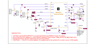

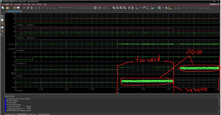

we have did the spice simulation for DRV8256 using (DRV8874 model) please find the noise generated in the circuit, request to confirm if we can proceed or need to take any precaution in new design.

Simulation circuit
Simulation wave
The part where noise occurs is because drv8874 does not have a noise model.
  1. When the 100w motor is under the spike load condition
Since the provided drv8874 spice model does not provide noise characteristics, it is difficult to simulate spike load.
