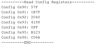

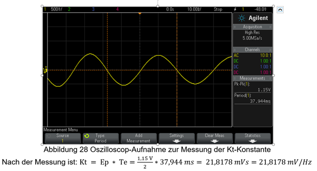

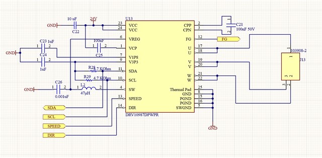

I’m using the DRV10987 to drive this BLDC-Motor (https://premotec.home.xs4all.nl/pdf/brushless/BL21%20EE-1.0%20Watt.pdf
I configured the Reg 0x90 to 0x96 with all needed Parameter to start a first Test. I have also enabeld the Driver by wirting 0x0000 in Register 0x60
The Problem is, that the DRV10987 is not providing any Power on the Motor phases.
I have tried both; PWM and analog Signal to Speed Pin without any response from DRV10987. on the DIR Pin I tried Low and High signals
can you please tell me what am doing wrong. In the Attachment you can find the Configs of the Register.
