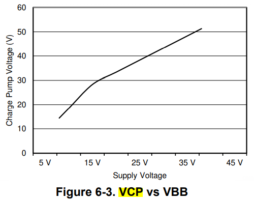

I'd like to know about the UVCP detail.
What are the conditions under which the UVCP fault occurs?
Is this fault just a notification and will affect the DRV8800 behavior?
My customer has always the nFault output is low.
They checked the voltage of VCP that is 32.4V(VCC is 33V).
Sincerely.
