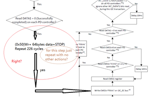

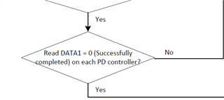

    - The two writing actions for PBMs are right until the data1=0 as below:
    For patch bundle need to follow the following protocol, the first bit with slave address, which defined in PBMs DATA pack, has no ACK. The the following steps can not be continue.
    I there are no EEPROM external. Does the slave address also 0x05?
    Matt

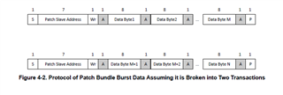

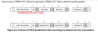

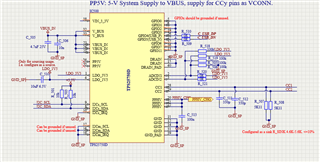

  • Hi Chuck,
    Could you please help to check the solution once more:
    - This is the hardware that i debug the software with: VIN_3.3V, I2Cs_IRQ are like shows below, is that affected the PD controller working?
    - The patch bundle break issue.
       Firstly, to follow the protocol as above shows.
     When break the 14464 bytes to 226*64bytes, is that to do just repeat like that was marked in the figure? do we need other  CMD and DATA reg wr/rd steps?
    Please help to check the both again. It seems will be succeed, but not actually. It's bad feeling.
    Matt
  • Chuck,
    I will assemble a new PCBA, correct the circuits according to your suggestions. I think this old PCBA maybe cannot be used any more. Maybe mislead me in wondering.
    Matt
