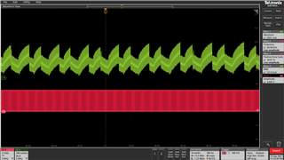

    In PH/EN mode, while reducing the PWM in EVM board keeping IN1 as PWM and IN2 high. Below 15% the motor could not run.  This is same in our custom design.
    Whereas in PWM mode, while reducing the PWM in EVM board. Below 55% the motor could not run. This is same in our custom design.
    Attached the scope shot for PH/EN mode, with current (Green) and PWM duty cycle (Pink) for your reference.
    Working Condition
    PWM below 15% motor not running
  • Hello Anjanaa,
    Thank you for the promptness and thoroughness of your response. These data is valuable. The fact that PH/EN mode is supporting lower duty cycles than PWM makes me believe that there might be a problem sustaining current through the motor to the point that it can't continue to spin.
    A little bit of background on this: Phase enable mode only supports slow decay, while PWM mode allows for the device to utilize fast decay. Due to this it would be expected for phase enable to sustain lower duty cycles without having the motor stop spinning due to an unbalance between current provided and current decay.
    To make sure that the lack of spinning below 50% is indeed a current decay issue and not a driver or IC issue, I would like you to do some testing with a resistive load. Use a 16ohm resistor instead of the motor. Then probe the oscillating input and the output to which the resistor is connected. The input should follow the output throughout all duty cycles. If you could provide scope shots of this it would be valuable for evaluation.
    If the output follows the input at all duty cycles it would support the idea that there is a current decay issue with the motor you are using indicating it is too big. This would mean that in order to drive it you would need a higher Vm or know that your operational range will duty cycles 50%-100% in PWM interface mode. Alternatively if voltage needs to be 19V, and you need the full range of duty cycles you should consider a different motor.
    Please let me know if there is anything else I can help with or any questions you might have,
    Pedro Arango Ramirez.
