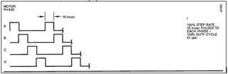

Hi, I'm trying to drive a stepper motor in the wave drive excitation mode. Looking to get 16.0 ms pulses at each phase at 61.04Hz, 100% duty cycle. Trying to figure out how to pulse the STEP line to achieve this.

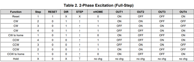

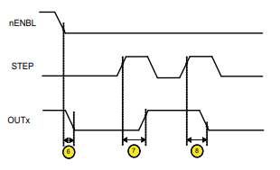

I'm a confused on the timing correlation between STEP and the OUTPUTS. The image from the datasheet below seems to suggest that pulse the STEP high once turns OUPUT1 high and pulsing the STEP again brings OUTPUT1 low,  while simultaneously bringing OUTPUT2 high? If I have rising edges on the STEP every 16ms does that achieve the wave drive I'm looking for? How long would I want the STEP to be high or low though in between.
