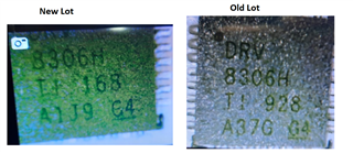

We have tested DRV8306 with two lots. We found the phase commutation logic inconsistent. Please refer attachment.
The phase connection U, V & W does not work in New lot (V W & U works).
Please justify the above. All our circuitry and components are fixed, then why same IC behaves differently?
Avinash M.
  • We have tested the IC on the same PCB with the same motor and connection. We found both ICs are logically inconsistent. It seems that the phase connection within the IC package has been changed. The phase output in our Old lot is UVW, however, in a new lot, it is VWU, remaining all setup and connections are the same.
  • Hello Mechtex,
    Can you please send an image of the top of the package for each lot of devices?
    Matt

  • Hi Aadit,
    Closing this thread now that the technical debug portion of the e2e has found root cause (capacitor value mismatch on PCB component population).
    For ongoing discussions on sampling, NDAs, etc -> continuing discussion via email.
