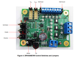

Hi team,
Our customer has issue that they can not make motor rotate with DRV8306EVM. Please review below situation and give me advise
<Input/Setting>

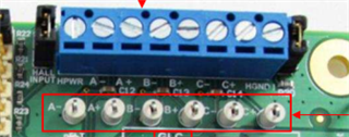

VM=12V, PWM:30kHz, 3.4V, Hall Element connected to A+-~C+- powered by 3.3V with JP1,2, EN switch=ON
<Output>
370mV is measured at every OUTx (A, B, C) constantly. The indicator LED is nFAULT:OFF, DVDD:ON, VM:ON.
