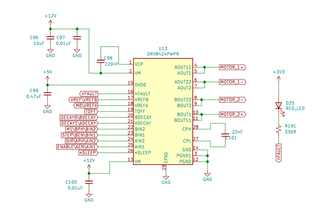

Hi ,
I am using drv8424 motor driver to drive stepper motor named 42HD4027-01 (NEMA 17) . The motor is not rotating but i can hear some noise. I am handling 4 pins from controller namely DIR,STEP,nSLEEP,ENABLE. I am setting nSLEEP ,ENABLE ,DIR high and giving a pwm signal to STEP designed for 10rpm . May i know what is the reason for not rotating . If anyone can support it would be helpful. Please support ASAP'
I have attached pic showing m0.m1,decay0,decay1 connection
Thank you .

  • Hello, Rakshitha,
    1. Do you check it on an EVM?
    2. Since I didn't see the output voltage or current waveform, I am not sure the output is enabled or disabled. Would you measure each pin voltage when you run the motor?

  • HI,Thank you for the reply
    1. NO ,I haven't
    2. Output voltage is not proper aout1,aout2 is getting 12v and bout1 is getting 5v and bout2 is getting 0v
  • Rakshitha,
    Have you tried more than one IC?  Sounds like this one may have been damaged somehow.
    Ryan
  • No I haven't , Is the procedure what i am following is correct ?? So that I can arrange another IC. The MO,M1, DECAY0,DECAY1 connections i am giving manually is it ok or i should switch to program?
  • Rakshitha,
    It is Ok to add M0, M1, Decay0/1 manually. Let us go through debugging process. In general, we need to:
    1. Check the schematic if it is not an EVM.
    2. If it is thermal issue or noise issue, we need to check the layout.
    3. Provide the test waveform according to the issue (So far, we don't have it.)
    4. If we cannot have the waveform, measure each pin voltage (or check all register value if it has) to make sure all inputs correct.
    5. Check how many boards do we build? Does all the board have the same issue? Swap the IC between good board and bad board. If only one board, try more IC.
    Please provide enough info to step by step debugging.
    Wang Li
    These are the output wave forms . I am getting a pwm signal only at bout1 , I have changed IC , I have added our schematic and code here. I have manually connected vref , vrefA/M0 pin to high.

  • vref ,vrefA/M0 voltage is 3.3v and Vm voltage is 12v
  • Rakshitha,
    The schematic looks OK to me.
    "I am getting a pwm signal only at bout1" How about bout2; aout1 and aout2? Would you share the waveform?
    Wang Li
