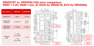

    1. Noise can occur in the DRV8316's CSAs through a few methods. Ideally the noise should be 0mV for each SOx output, but we have found that there is 4-5 mV of noise due to coupling from internal ground differences. This is more noticeable at higher currents (OUTx > +/-4A), so the mV of noise should be negligible for 0.2A peak current. Also regard in mind possible sources of error in the current sense amplifiers for the DRV8316, I have attached a screenshot below that compares DRV8316 to DRV8304 (internal CSA vs external CSA) showing the possible sources of error:
