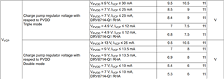

If I use VCP pin to drive external circuit, how much current can I get?
