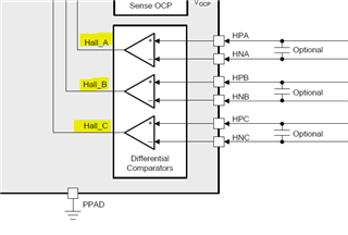

    3.Both asynchronous and synchronous debug modes have the Align process, why it isn't  the rotor pre-bit processing? The MCT8316Z supports the trapezoidal waveform control algorithm for Hall sensors. For BLDC square wave control with position sensor support, is pre-set processing also required?
    Can you please elaborate what you mean by "rotor pre-bit processing" and "BLDC square wave control"? The MCT8316Z has Hall comparators that can accept digital or analog Hall inputs and will commutate the motor to the next state based on the 1x PWM commutation table in the datasheet. All you need to commutate the motor is Hall sensor feedback to HPx if using digital inputs or HPx/HNx if using analog inputs. The device will detect the BEMF crossings automatically and determine whether Hall_A,  Hall_B, and Hall_C are true depending on the mode setting.
    In the DRV8306 datasheet, these signals look like this. I don't think this is shown in the MCT8316Z datasheet. So for Align, the internal Hall_A, Hall_B, and Hall_C must be true to align the motor.
