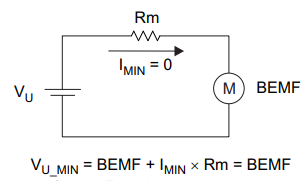

    If the speed command suddenly drops such that the BEMF voltage generated by the motor is greater than the voltage that is applied to the motor, then the mechanical energy of the motor is returned to the power supply and the VCC voltage surges. The mechanical AVS function works to prevent this from happening. The DRV10983 buffers the speed command value and limits the resulting output voltage, UMIN, so that it is not less than the BEMF voltage of the motor. The BEMF voltage in the mechanical AVS function is determined using the programmed value for the Kt of the motor along with the speed. Below figure shows the criteria used by the mechanical AVS function.
    Inductive AVS does not work in DRV10983.

    Thank you for the swift reply. Yes I understand the functionality, but since when I give speed command zero the Vu should eventually turn out as 0V and the buffer also should turn out 0%. But it was observed that the buffer as well as the RPM read were non zero even when the motor had stopped rotating.
    The motor was at halt but the buffer still kept showing PWM period percentages and the RPM read was still non zero, noting that the BEMF when the motor is at halt should be zero.
    I did not understand this behavior !
  • Himanshu,
    Looks like the programmed Kt value might be too high. Can you reduce the programmed Kt and check if it improves? If you see the difference between Speed Command and Speed Cmd Buffer getting closer, continue to reduce the Kt, until they are the same.
