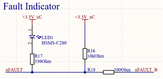

I'm using the DRV8350F (the F version because of a STO performance level e) and it seems, the fault indicator never triggers. I had a DRV8320
before and exactly the same fault indicator circuit, which worked fine there, so I don't think that should be a problem:
nFAULT is connected to the nFAULT pin of the DRV8350F and also a measurement with the oscilloscope shows, that nFAULT is always high, also when a VM undervoltage should be
triggered (VM is switched off by a transistor). nFAULT_B is connected to a uC Input. If VM goes to 0V, the motor controller does not work anymore (gates floating) as it should, but the nFAULT pin is still pulled up.
Is there any known problem of the fault indicator or what could be the cause of this problem?

    1. what is nFAULT_B in this case? Is this a connection between the DRV device's nFAULT pin to the microcontroller IO input or something?
    2. when you trigger VM switching off with a transistor, are you also doing anything to the 3.3V supply rail?
      1. in order for the nFAULT diode to turn on, it needs to be forward-biased with a voltage drop & conduct current (3.3V on the supply rail, and 0V on the nFAULT pin itself)
    3. is the nFAULT pin on the DRV8350F 3.3V logic high during regular operation?
      1. when the UVLO fault occurs, does it still read 3.3V on the scope, or is the pin observed to be floating instead?
    4. Does nFAULT LED light up for any other fault conditions?
      1. it may be worthwhile to check the related components on the board to make sure R17, LED1, R16 are not damaged and also have the correct values
      2. also may need to check that there is continuity between nFAULT pin of the DRV IC and the R16, R17 resistors - just to confirm the signal path is intact
    5. If these debug items don't work, it may be worthwhile to try soldering on a fresh DRV8350F part or try replicating the issue on another copy of the same PCB (to help rule out component damage)

    1.) nFAULT_B goes directly to the microcontroller input (verified, it is not an output)
    2.) No, the 3.3V supply rail is always on, it just turns off the +12V supply for VM (verified with an oscilloscope).
    3.) Yes, the logic pin from the DRV8350F stays always high (measured with an osc), also when I disable the controller over the disable pin (I think in sleep mode, the indicator should also be low, right?) I will try out some other failure modes just to see, if they might give another result.
    4.) I can never see the LED light up, so it seems never to get triggered. The related components are finde and have the value as in the schematics above after measuring with a DMM. Also the connection to the DRV8350F is fine.
    5.) I have the same issue on 10 boards, so this is really strange.
    Edit: What I now see is, that the LED has a forward voltage in both directions, so there might be a short over the LED and 10mA current could have been flow. Is it correct, that the nFAULT can handle a maximum of 5mA?

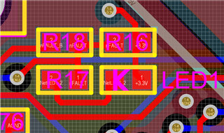

  • Hi Andrew,
    I used now a completely new hardware, desoldered LED1, R17 and R18 and I get exactly the same issue. When I use an input voltage (Vdrain) of 5.5V, I still have a high indicator, aswell for a VM of 0V. There is nothing more connected to the nFAULT pin now, only a 10kOhm pull up:
    I really can't tell what is wrong and since it worked fine with the DRV8320 there might be another issue here. Might it be possible, that it has something to do with the splitted supply of VM and VDRAIN? VM uses directly a +12V regulator, VDRAIN is connected to the input voltage. I will anyway try to feed VM also directly from the +48V supply to see, if then the indicator works fine.
    (R9 and R8 are not assembled)
    Greetings Sebastian
