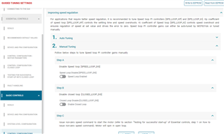

  • Hi Mitcham,
    The closed loop may have been unstable due to the speed loop Kp and Ki values entered. If MPET is not able to determine the speed loop parameters automatically, we do have a guided tuning section to manually determine appropriate values for your motor. Might be worth a try to follow the step-by-step instructions:
    Eric C.
