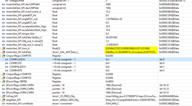

I am utilizing LAUNCHXL-F2800025C and a DRV8353RS-EVM to work through the Universal Motor Control Lab.  In the Universal Motor Control Lab incremental build level 2.  I am getting moduleOvercurrent faults.  I have successfully completed the lab through build level 1.  The DRV8353EVM does not indicate a fault nor do the registers from the 8353.

  • Which motor is connected to the inverter board? Or any load is adding to the motor? Did you try to run the lab without connecting the motor first or without adding the load?
    If you are not using the example motor in user_mtr1.h, you need to follow the guide to set the right v/f profile, maximum current and over current limitation parameters according to the spec. of your own motor.

    Why is the CMPLLATCH bit being set?
    That means there is over current fault because the incorrect the v/f profile. You might try to set motorVars_M1.flagClearFaults to "1" to clear the faults, and then to re-start run the motor.
    Or you might skip the build level 2 to run the build level 3 or 4 since you are using the kit supported in the lab.

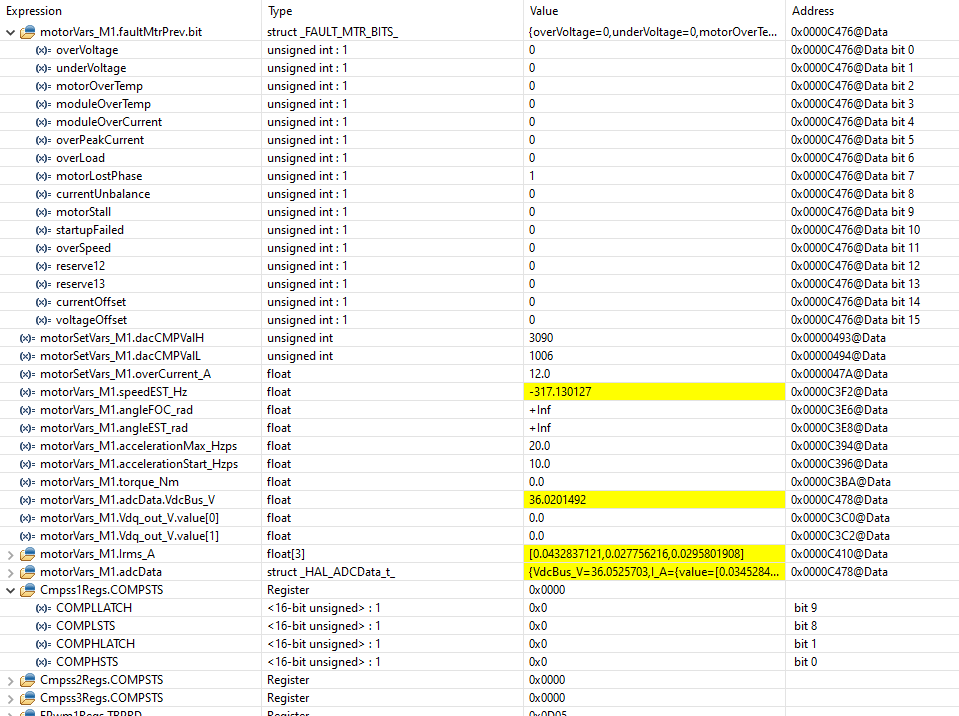

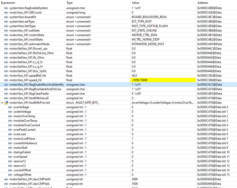

    I wanted to give you an update.  I ran build level 3 and 4 and I did not get the moduleOverCurrent faults.  But now I am getting motorLostPhase indication as shown below.  I assumed that it might be a bad connection but I checked that.  I have had the same motor running with a F280069M and a drv8305.  But I am setting up a different motor to test with just to rule it out.  I just wanted to keep this thread going.  Any insight would be appreciated.
  • This fault has been blocked and it is not used in this lab, it's just for debugging.
    You might change the following parameters in user_mtr1.h file for this fault detection.

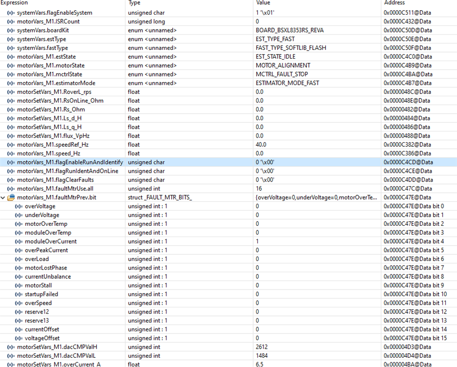

  • Hey,
    I am having exactly the same issue. For me does not get clear how it was solved.
    Can you summarize what to do?
  • It's not totally resolved for me.  I tested it with a different smaller motor and determined it was not the kit.  I now have to figure out the appropriate settings for the motor parameters.  Unfortunately, I can not find any documentation on how to determine the appropriate values for all these seemingly redundant parameters.  Deriving them from nameplate info seems impossible.  I had both of my problem motors spinning with the old labs which had a lot fewer parameters to configure.  Now, these new parameters have to be set and I can not find any documentation on how to do that.
  • If you are using the TI hardware kits supporting in this universal lab, you don't need to run the motor with build level 2, you can directly run the build level 4 to identify and run the motor, and see what happens.
  • Hey,
    I am using a different motor for the development.
    The motor parameters are below.
    The Phase current is measured @ 2.78A per phase and that triggers ModuleOvercurrent. Tracking the nFault pin no fault is set by the driver and also the driver registers are not showing any fault.
    What triggers the Module overcurrent, like the case above? I have the same and it is not a fult coming from the 8323 DRV.

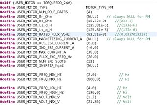

  • I was able to get one of the motors or one very close to one of the motors listed in the headers files and I am able to get that to work.  So my dev kit is functional.  I have it working with all levels.  My problem now is to get it to work on the actual motor for my project.  The motor is bldc 3000 rpm 36V 200W motor.  I need to know how to go from that information to all the 50 undocumented parameters to get it to spin.  I am able to spin them with the old insta-spin firmware.  But I want to use the current SDK and LAUNCHXL-F280025C.
  • All of the used parameters have been described in the user_mtr1.h, and only the documented parameters are used for the motor control with FAST estimator. You can still refer to the InstaSPIN user's guide for these parameters if you want to implement InstaSPIN-FOC with FAST for motor control. The other parameters are only used for fault protection as the commented description in the header file.
    You only need to change the motor parameters, maximum current and over current value in the current example lab for your motor.
    #define USER_MOTOR1_TYPE                   MOTOR_TYPE_PM
    #define USER_MOTOR1_NUM_POLE_PAIRS         (4)
    #define USER_MOTOR1_Rr_Ohm                 (NULL)
    #define USER_MOTOR1_Rs_Ohm                 (0.38157931f)
    #define USER_MOTOR1_Ls_d_H                 (0.000188295482f)
    #define USER_MOTOR1_Ls_q_H                 (0.000188295482f)
    #define USER_MOTOR1_RATED_FLUX_VpHz        (0.0396642499f)
    #define USER_MOTOR1_MAGNETIZING_CURRENT_A  (NULL)
    #define USER_MOTOR1_RES_EST_CURRENT_A      (1.5f)
    #define USER_MOTOR1_IND_EST_CURRENT_A      (-1.0f)
    #define USER_MOTOR1_MAX_CURRENT_A          (6.0f)
    #define USER_MOTOR1_FLUX_EXC_FREQ_Hz       (40.0f)
    #define USER_MOTOR1_INERTIA_Kgm2           (7.06154e-06)
    #define USER_MOTOR1_OVER_CURRENT_A         (6.5f)           // A
  • I have changed those parameters but I am getting a lost phase fault because the motor is not spinning.  This is repeatable on 2 different motors that are similar one is a 200 watt and the other is a 100 watt.  But if I use a smaller motor with the kit everything is fine.  What parameters should I look at?
  • As mentioned above. The lost phase fault is disabled in the lab by default as the following definition code in "motor_common.h". There are only over current, over voltage, and under voltage faults are enabled in the lab.
    #define MTR1_FAULT_MASK_SET             MTR_FAULT_ENABLE_OC_OUV
    You might change the values for the following parameters if you want to enable this lost phase fault protection, like increasing the value of USER_M1_LOST_PHASE_TIME_SET.
