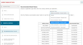

    No of the recommended settings starts my motor. The first two (ultra slow acceleration and slow acceleration) get my motor to run about a quarter turn and stop.

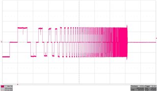

  • When I use the default ultra slow acceleration setting, motor run 2 or 3 complete turns and stop (Sorry not a quarter turn as I mentioned earlier). Abnormal Speed [ABN_SPEED] fault was triggered. When motor stopped running, some weird acoustic noise continued for some time, goes up in frequency and stop after several seconds.
    This the waveform of the failed startup.

    From your waveform, it looks like the open-loop to closed-loop transition isn't very smooth, indicating the rotor may not be in sync with the commutation.
    One thing to try is to make sure that the motor is properly aligned during startup to ensure maximum torque is applied during open loop, so configure to double align with align time of 4s or higher:
    Could you also please ensure the open loop current limit [OL_ILIMIT] is also set to a similar value as the CBC current limit [ILIMIT]:
    Also try increasing the number of Open Loop Handoff Cycles [OL_HANDOFF_CYCLES] to 12 or even 24 and see if it helps.

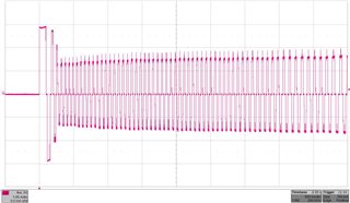

  • Here are the current waveforms of successful startup without load and unsuccessful startup when some load is added.
    This is current of successful startup when no load is added
    This is unsuccessful startup when some load is added

    For comparison, here is the current waveform of successful startup when the same motor is driven with DRV11873 under same input voltage and slightly heavier load.
    It should be noted that the A/Div of this waveform is different from the waveforms shown above. Time/Div is the same.

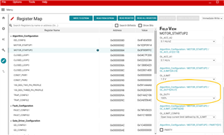

  • Yes, the motor vibrates when it failed to start under load. Abnormal Speed [ABN_SPEED] fault is the only fault triggered. I guess this is triggered after the driver lose sync with the motor.
    I also think the issue is insufficient driving current even though I believe all current limit configurations in the GUI are set to the maximum and my power supply is more than capable of supplying enough current and not tripped. I even test at higher input voltage and get the same result. Something must be limiting the current.
  • This appears to be at least a part of the reason why driving current is limited. The default setting is something like 25%. After I set it to 100%, motor current is much higher under the same input voltage. The startup torque is also higher and the startup is faster.
    But the name of this setting (OL_DUTY) seems to suggest that it only affects open loop. Are there other setting that affects close loop current limit?
  • Ok, so it is the open loop duty cycle that was limiting the open loop current. Closed loop current limit is controlled by the Cycle by cycle current limit [ILIMIT]. Please make sure the CBC limit is set to a value that is slightly greater than the rated current of your motor.
